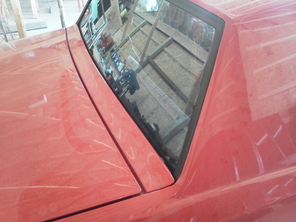

Got the trim on around the back window

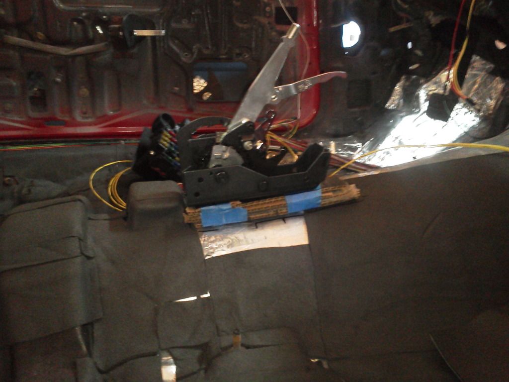

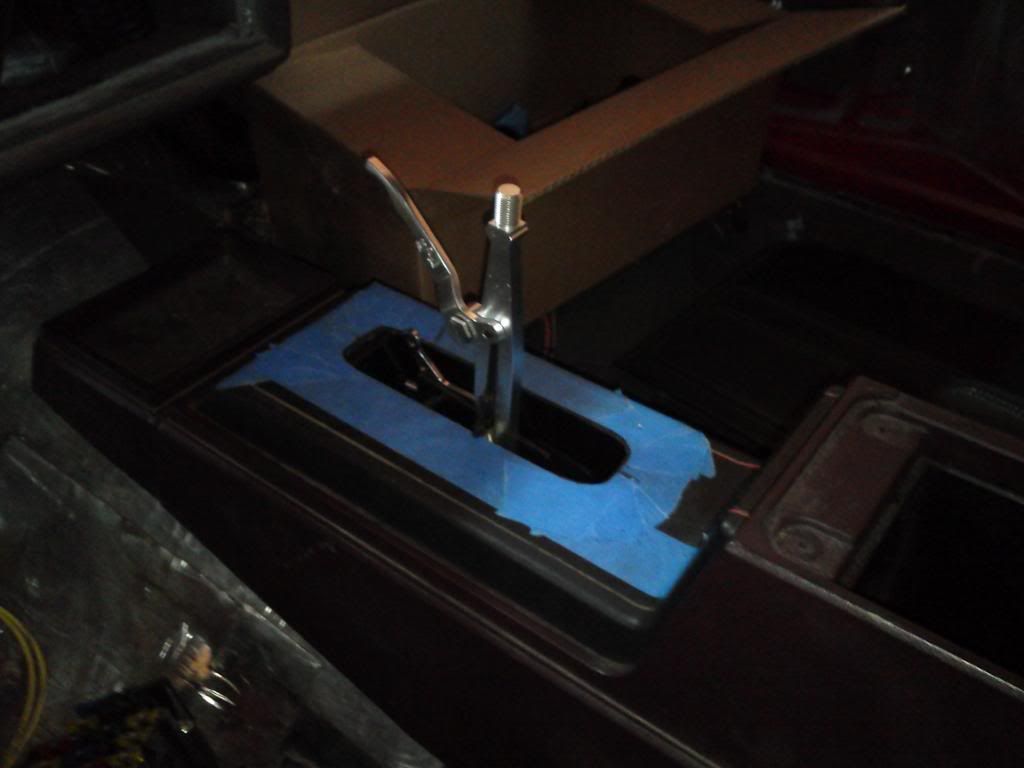

then I started mocking up the B&M shifter so that I can make a bracket that will allow it to fit in the factory location
I also got the heat delete plate on and notched out a small section of it for the bolt that I used to mount the heater and did some grinding on the firewall so that I could put stainless bolts on for the pedal assembly.

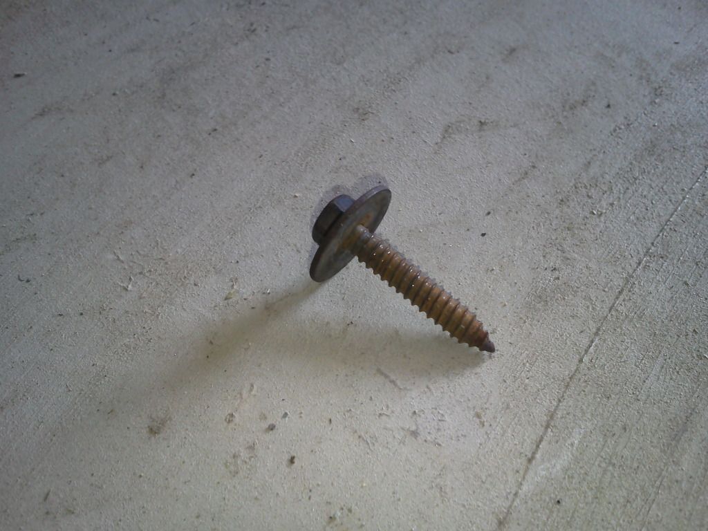

I plan on running all stainless bolts on the car and I went to fastenal to try to find a stainless bolt like the ones that hold on the heater but didnt have any luck. Does anyone know where I could possibly find these in stainless?

Here is a couple of ideas on the fasteners. Good luck on finding stainless. JMO- I wouldn't use standard stainless fastener on anything that will see alot of stress. Stainless is used mostly for corrosion protection, most stainless fastener are only as strong as a grade 5 bolt. ARP Fastener makes super strong stainless bolts. Below are a couple of other suppliers that you can check out:

Thanks for the info and the link miker. There wont be much stress on the delete plate so stainless shouldnt be an issue there. I figured itd be a dead end trying to find them but if theres anybody that knows there probably on this site. I was just hoping to find a stainless version of that bolt mainly because I think it'll look nice. But if I don't have any luck I'll just drill and tap all of the holes.

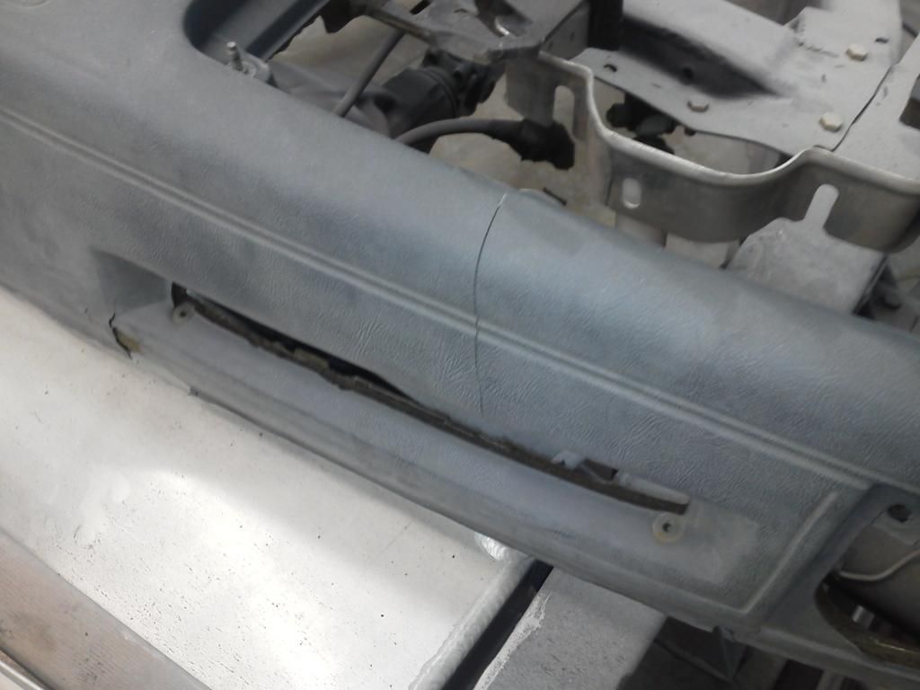

Got the bracket made for the B&M shifter and modified the shifter cover so that it will fit. Now I'm waiting to get 4th gear cut into the gate plate I bought since I'm going to be running a 4 speed reverse pattern. Once that comes in I'll be able to bolt it down and make sure there are no issues with the shift cable.

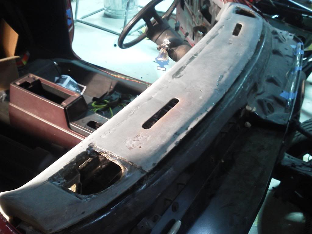

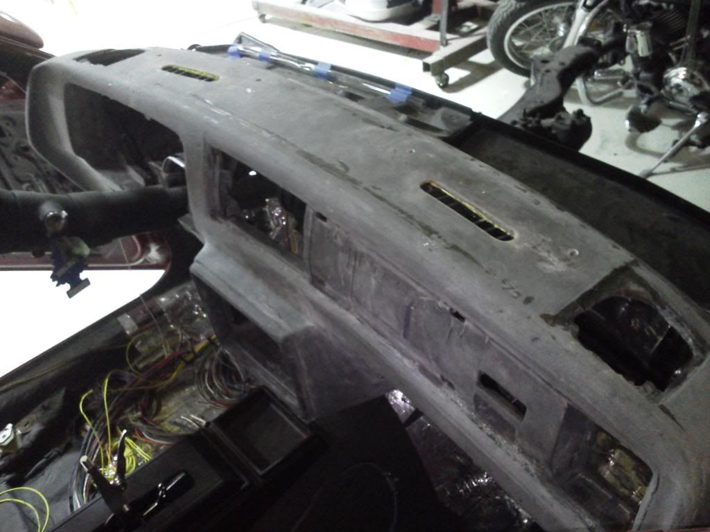

I also began working on the dash. For awhile I was considering getting a cover for it but instead I decided to fiberglass it.
I completely filled in the defroster vents and once I get the rest of the dash fiberglassed I am going to cut out just what is needed for the new vents that came with the heater setup I bought. I'm also going to be smoothing out the rest of the dash pieces so that everything matches.

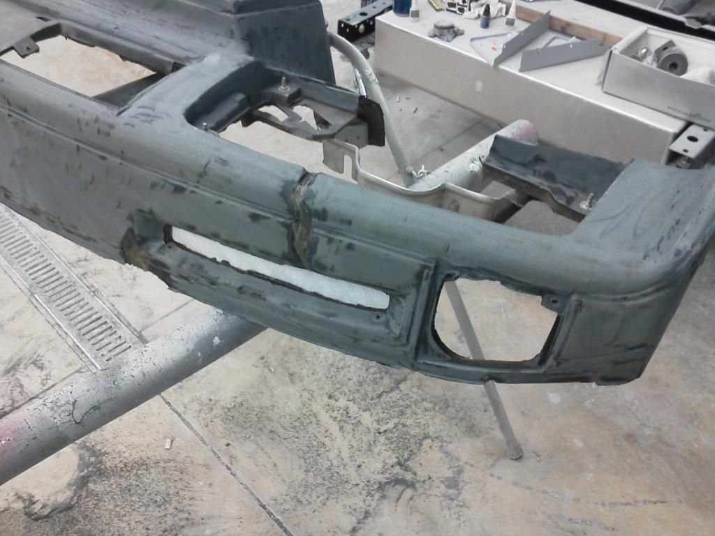

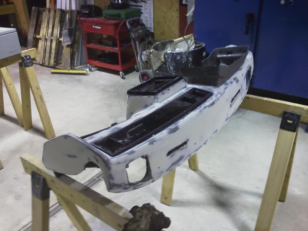

Got the dash fiberglassed and sanded and then cut the holes out for the defroster vents. Now I just need to mount the vents then spread some icing over the low spots and get it ready to primer then paint.

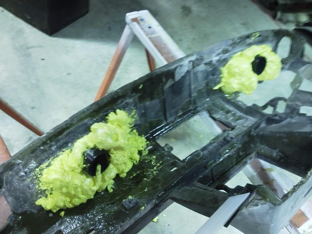

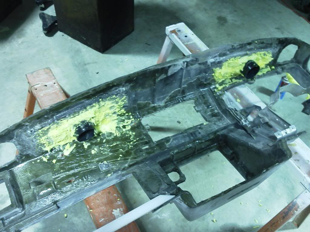

I decided to use spray foam to hold the vents in place so that I don't have to have any more holes in the dash, plus it will act as an insulator.
Got the foam shaved down.
I also countersunk the holes so that the screws will be flush with the dash once its mounted.

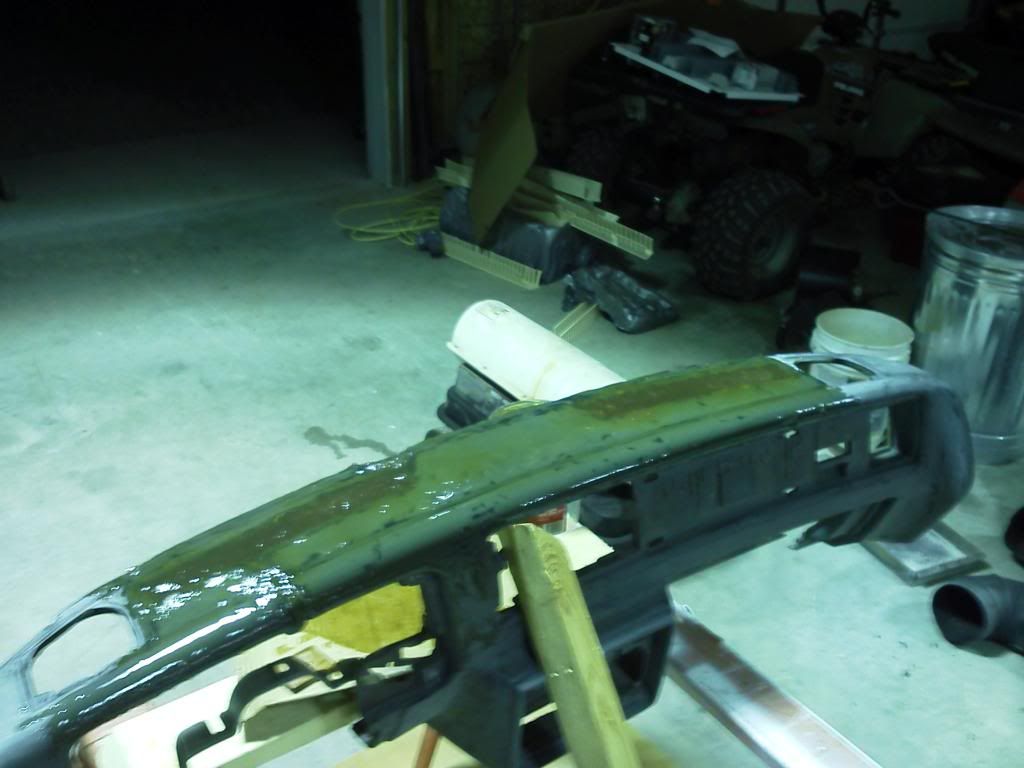

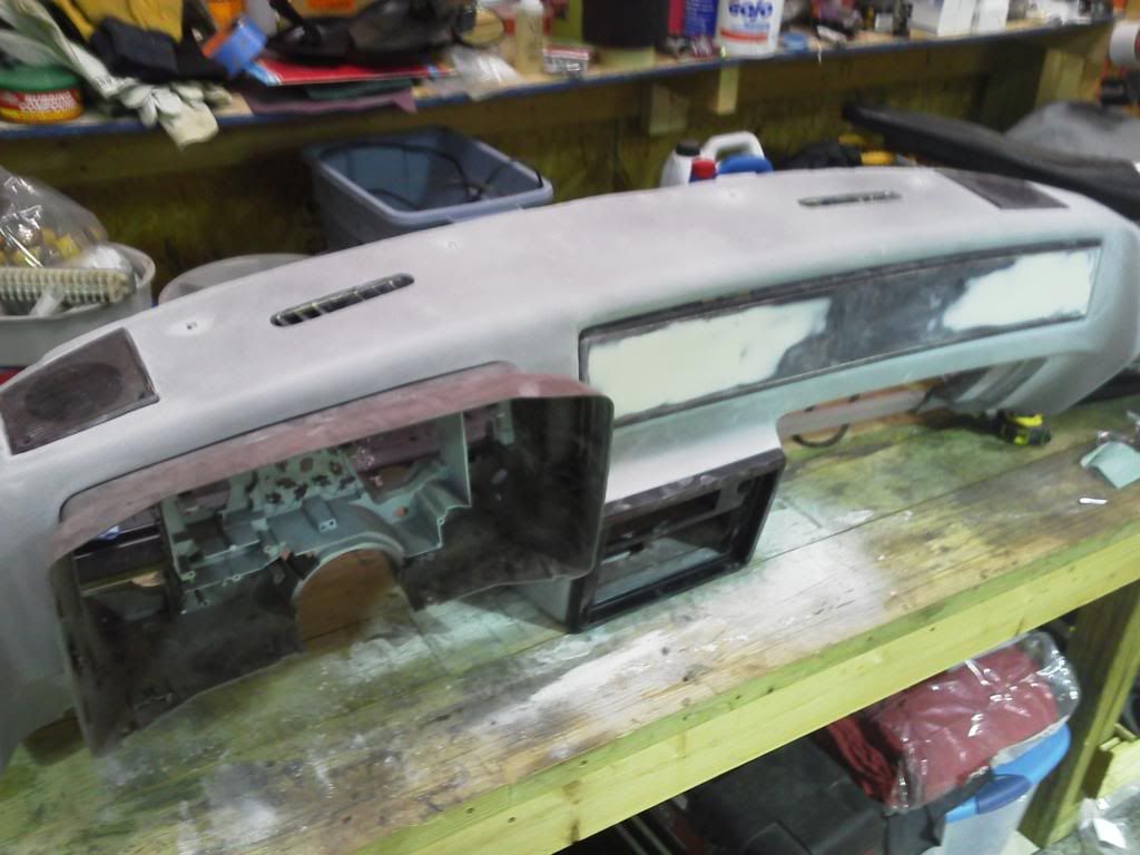

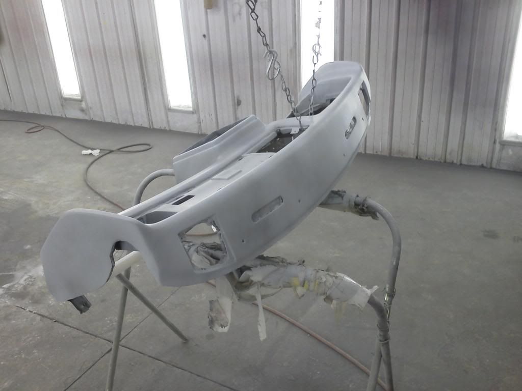

Spread a coat of icing over the whole dash then sanded it smooth and double checked to make sure that everything still fit in the dash.
Then I primed the dash and it'll stay in primer for awhile until I figure out where I'll be mounting a few toggle switches and what radio and gauges to run.

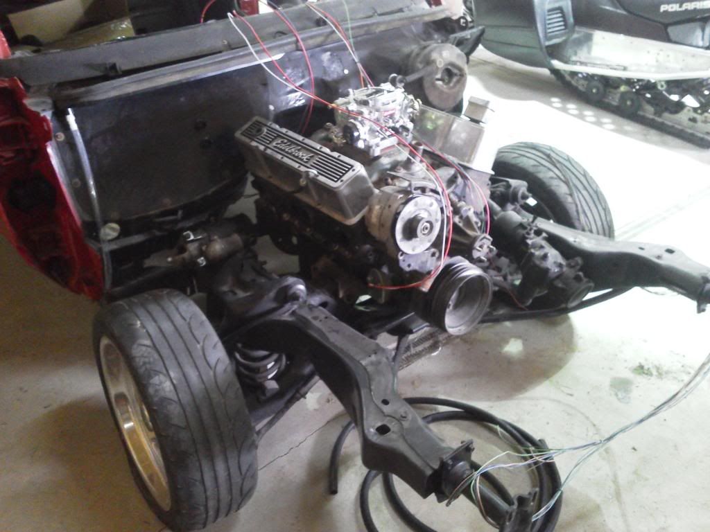

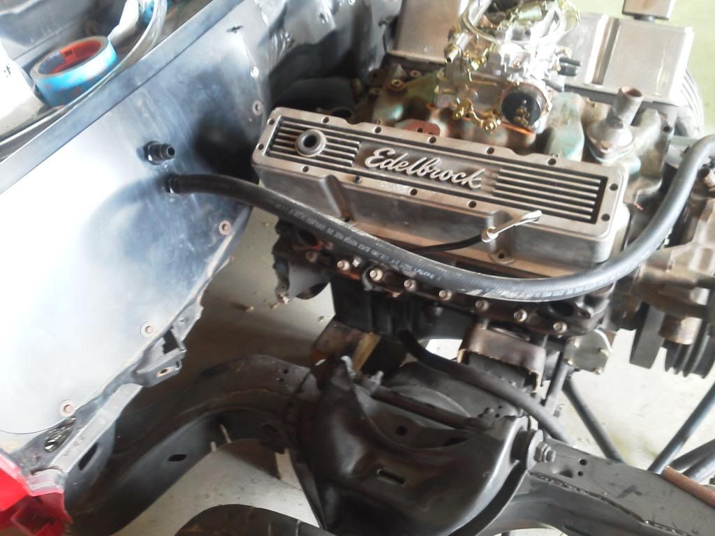

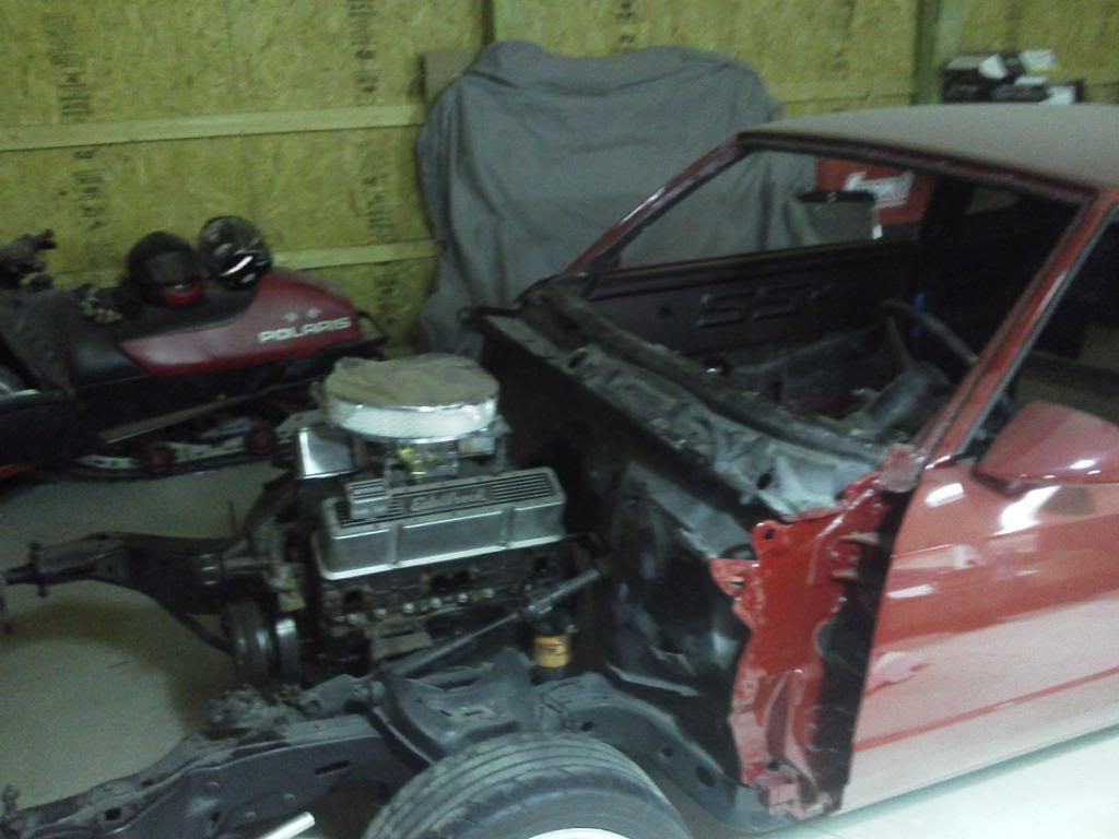

I also put my 350 in so I can start mocking up where I want to plumb the water lines for the heater and the wiring for the engine bay.

Began the final sanding on the dash over the weekend and checked again to make sure that everything still fits and lines up. I also blocked off the original vents then sanded them smooth.

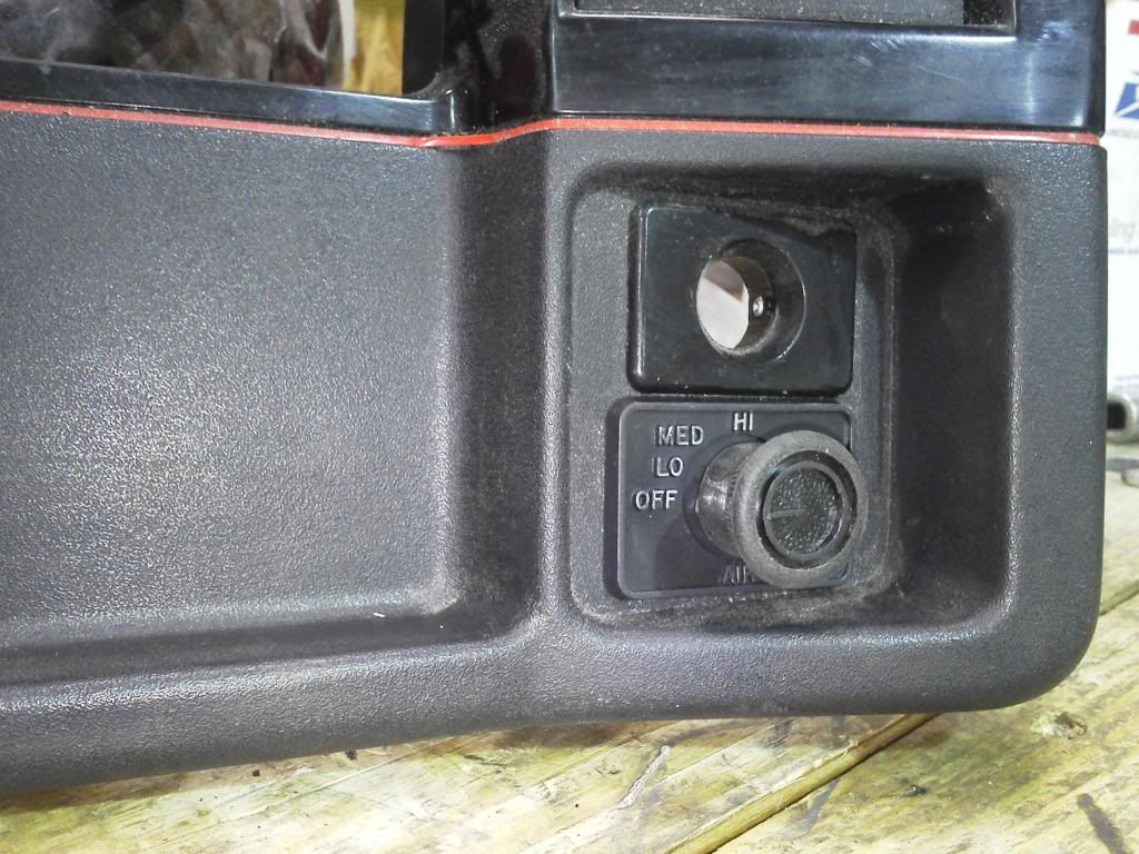

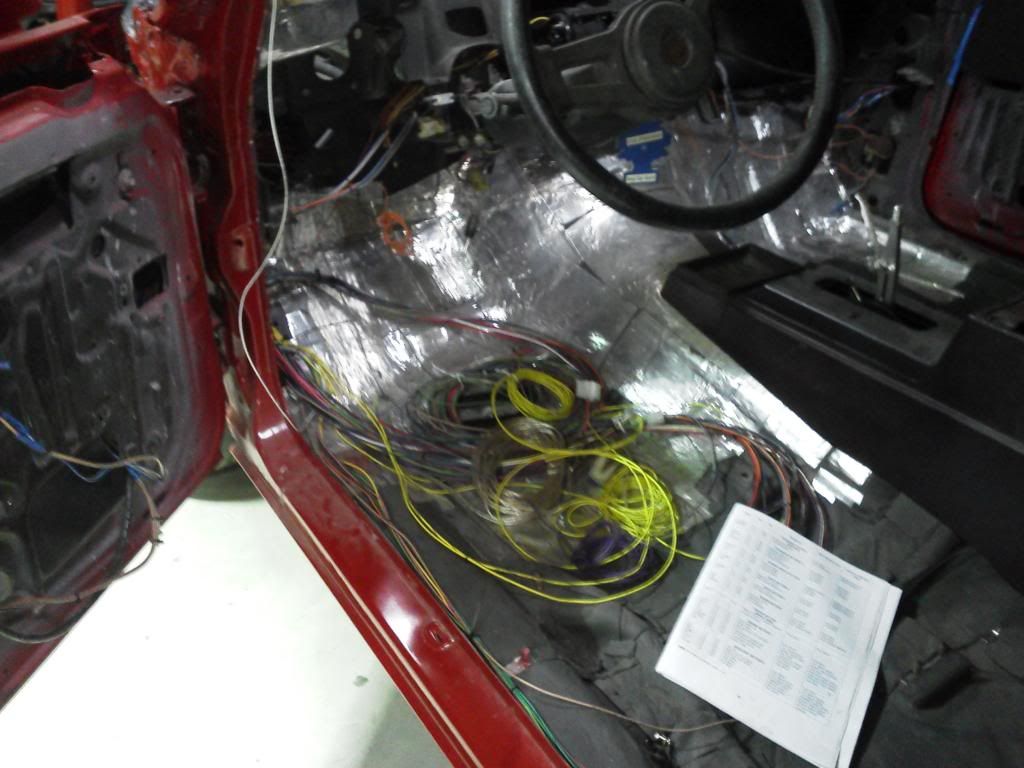

Finally got a free day to work on the car again. Awhile back I purchased an aftermarket cig lighter and I got that mounted inside of the center console to free up room in the dash to eventually install a in-dash touch screen. Over the weekend I ran the wire to the console and began building new door harnesses using the original plugs and clips with the new wire from Painless. I got the power windows and locks wired up to the fuse block. Only thing left as far as the doors go is running power to the relay for the door locks since the relay wasn't figured into Painless Harness' wiring schematics. I also got the heater wired to the fuse block. I know how much everyone on the site likes pictures (myself included) so heres one..
There is still a lot of wiring to do but its getting there a little bit at a time. Next will be the steering column.

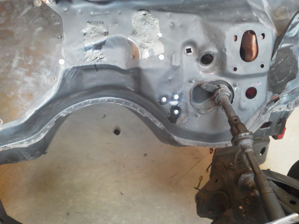

Over the weekend I got the steering column wired up. Then I installed two bulkhead fittings on the firewall so that I can run coolant lines to the heater. The line will be braided but I put this rubber hose over the fitting just to get an idea of what it will look like.
After that I went out to the parts car and started robbing a few parts off of it so that I could mock up the firewall before I eventually paint it red. Then I began running wire through the firewall. (My goal is to keep as many wires hidden as possible in the engine compartment) The wires for the front clip are coming through the firewall at a point near the hole for the e-brake cable then they will go inside of the fender up to the core support. The plan for the remaining wires is for them to come through the lower center section of the firewall.
After mocking up the firewall and finding a few more holes that I will need to weld shut I put the pedals back in the car, ran the ductwork for the heater, and then mocked up all of the wiring that will be running under the dash. Then I mounted the new heater switch where the switch for the rear defrost used to be.
