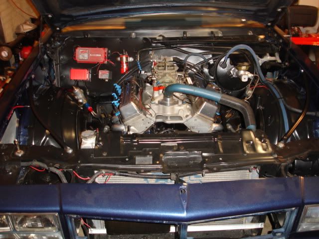

I am not running an LS but I am running a griffin radiator and I also have the Cutlass top plate on mine and have no issues with the fit. You should be ok with it.

Im running a Be Cool rad and its wide!
I trimmed the rubber mounts on the top plate to fit the rad.
