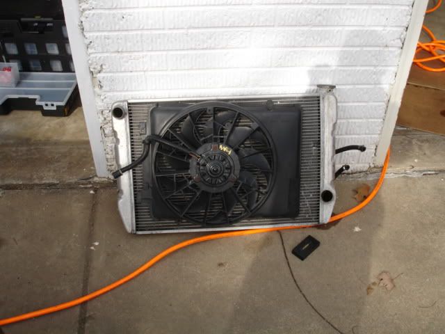

Here is a pic of my Taurus single fan after I took out the radiator for the frame off. This one fan works awesome...no over heating and keeps my 406 at 190* all day in the worst of heat. thumbs

One day I will make a shroud to cover the whole radiator. But you really can't see it when it is inside the stock fan shroud. It will push air out of the hood lines when it is on...and it's pretty quiet.
