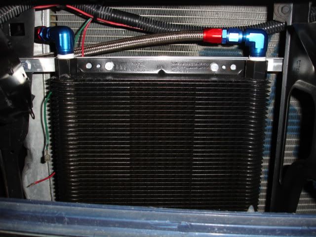

I just ran my new tranny lines not to long ago. I am at work and wil post the pics when I get home. I used -6 braided line and a B&M stacked cooler. Jegs has a nice kit to use that comes with all the stuff you will need. Here is the page they are on. This is the one I used.
http://www.jegs.com/p/B-M/B-M-SuperCooler-Transmission-Coolers/758370/10002/-1
Here is a shot of my setup with this kit.
