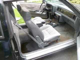

The Monte has been parked more than driven over the past year. I took it out yesterday and found that there was a puddle of water sloshing around the passenger side rear floor. Front passenger carpet was wet also.
Pulled out the wet vac and got as much up as possible but the under-padding is still soaked and the interior smells of milder in general.
First I thought it was from T Tops but its dry up there. Read some posts and maybe its the heater core or other seams up in the front.
Any ideas/suggestions on what to do next? I guess its time to replace the carpet but obviously I need to identify and repair the leak first.

Front looks like to much beer and bad kidneys. laugh
If it was the heater core you would smell antifreeze and the water level should be low. Easy test is to bypass the heater core. But, I would tend to rule out the heater core if it sat more than being driven unless the core has a big leak to allow it to drain.
With that amount of water in the back seat well I would suspect the T-Tops. Looks just like my 82 Vette. Check that with a water hose.

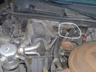

So I look under the hood earlier and noticed a big opening into the heater core area. I had a local shop replace the heater core a number of years ago and always found it strange that there was sort of a sponge over in that hole blocking it up. Now whatever that was is missing. This has got to be part of the problem.
I'm going to follow these directions Heater Core Replacement and pull out the blower motor and see if that vent is clogged up.

The sponge that was around the heater core inlet and outlet were fine, it keeps bugs and stuff from going in the box through the heater core inlet and outlet. Is not the heater core, thats way to much water, even if it could leak, you would see/smell it while your driving it, and even that, the car would start to over heat because of how much coolant/water is lost. Its either

Yeah... the heater core itself is not leaking. That's just plain water inside the car and the car was not overheating.

So over the weekend I sprayed the car down to see if any water was getting inside through the t top/window/door seals. Not surprised to find that there was water on both side but more worse on the passenger side.
Thinking back, the car was parked outside all winter long, nose high on a slight incline. Lots of snow this winter in NJ.
Somehow I can't believe it was just the roof leaks that allow that much water to pool inside. A water-proof car cover would have helped a lot over the winter.
Some pics...

check the csulking seal around the heatercore/ac box where it joins the firewall. I had a small leak that drove me crazy. I piulled it out and regasketed and resealed. OK now. Also check the wire harnes coming thruogh the firewall just below the heater. seal that one too.

One thing I did not see mentioned was the windshield area.
My SS had rust issues (having been bought originally in NJ) and holes behind the windshield trim at the upper corners were letting water in. Down the windshield pillars and all over the passenger side floor. If you drive in the winter months, then add salt to the mix.
The rear foot well though, that's probably the t-tops, but don't discount the rear quarter windows, or the back window either. Water leaks are the most difficult things to track down at times. Good luck.
