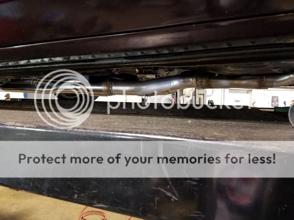

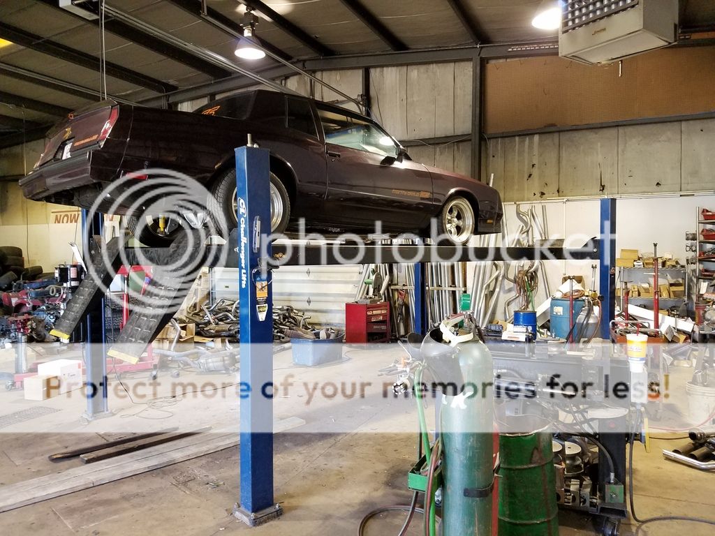

Well, my Monte came out of the dark for a ride to the muffle shop. They had to install two Flow Monster #410300 CAT's to get the car legal when you look under it. One MagnaFlow #10792 Tru-X Stainless Steel Crossover Pipes and two Magnaflow #14239 mufflers. They couldn't get the 3 inch pipe over the rear end on one side because of the bracket and brake lines I mounted in the way. They made custom turn downs that aim out just a little at the rear end till I move the the line. They were going to go over the rear end and down behind the back tires. These MagnaFlow muffles are so mellow I may leave it this way. It turns out that all of the guys there either race G-Bodies or Chevy 2's. The guys there are going let me try on their 2 inch drop springs for the back to see if I like 1 or 2 inch drop on mine. That way I get to see them on and get a good part number. I haven't drop the hammer on the car yet till I get it dialed in, but the car is never going to keep up with the rear tires. It breaks loose at will, the next problem to address. In first gear, dead stop, overdrive activated, the car is in launch mode. It hits first high by it's self at 20 MPH, half a gear lower than second. Hit the button and shift and your in second, hit the button and it's in second high, hit the button and shift your in third, hit the button and it's third high. Auto mode and it shifts in and out of overdive at 47 MPH. Second gear is fun, the button is all your hit, at will, to have second or a half gear less than third. It's easy to keep it in that sweet spot with six gears to pick from. A few odds and ends at home and it's off for a serious dialing in.

Curious what shop you used?
I'm very happy to live in a non-emissions inspection county.

Hey Ron!!! I would have done it there, but It was the last thing I was thinking About. I have a few more things to do before I put it to bed for the winter, but I'll do it.
Brian, It was always licensed at my lake home so it never had emissions testing. Now that it's registered in St Charles Mo with historical plates is never needs emissions or safety again. But If they catch your putting on exhaust on a car that had them, without them, it's 25000 dollar fine for the shop. I could have taken it to a near by county as I have before and not have them put on, but this is the last system this car will ever see again and these guys are the guys I wanted to do it and as long as they don't restrict, i don't care about the money. Their name is Complete Automotive and Custom Exhaust. They do 90 percent of all the rods in the surrounding area including all Fast Lane Classic Cars and all four by shops. I've known the guy for 35 years. Anyone that uses a pipe cutter so the pipe has the dimple or rolled edge from the cutter on it so it lays tighter to the piece your sliding over for a tighter weld seam is anal enough for me. That's what I call custom............

Ulli, I'm going to be praying for you new headers.. they look like they are hanging a bit low IMO. I hope it's just an odd camera angle...
I sure hope they work out OK, glad to see you're having some fun in the garage.
beer
#1045454 - 11/16/16 01:35 PM Re: The Last Dance [Re: Hey-O]
Posts: 1,644
Hey-O Offline
Hey-O  Offline
Posts: 1,644
St. Charles Mo
Hey Dave, your right, the drivers side even dips about a 1/4" more than the passenger side. The guys that put the exhaust on made note of it. These guys are g-body freaks and they spent some time taking notes on this and that under my car. They did note that they thought they fit as nice as they have ever seen. I've been driving it over different road conditions and got it to hit on a road with a short deep dip in it. I did this with these headers and old exhaust on and a pipe clamp with the threaded end aimed down to test this out. It hit the threads, but not hard enough to show. This system is on with a stainless steel band clamp which gives me about another 1 1/4 " more travel over my test set up. Yes, I will have to be more careful than before though. My real problem comes when I try to drop the back 2". The front may come up a 1/4", but the rest could get ugly.
