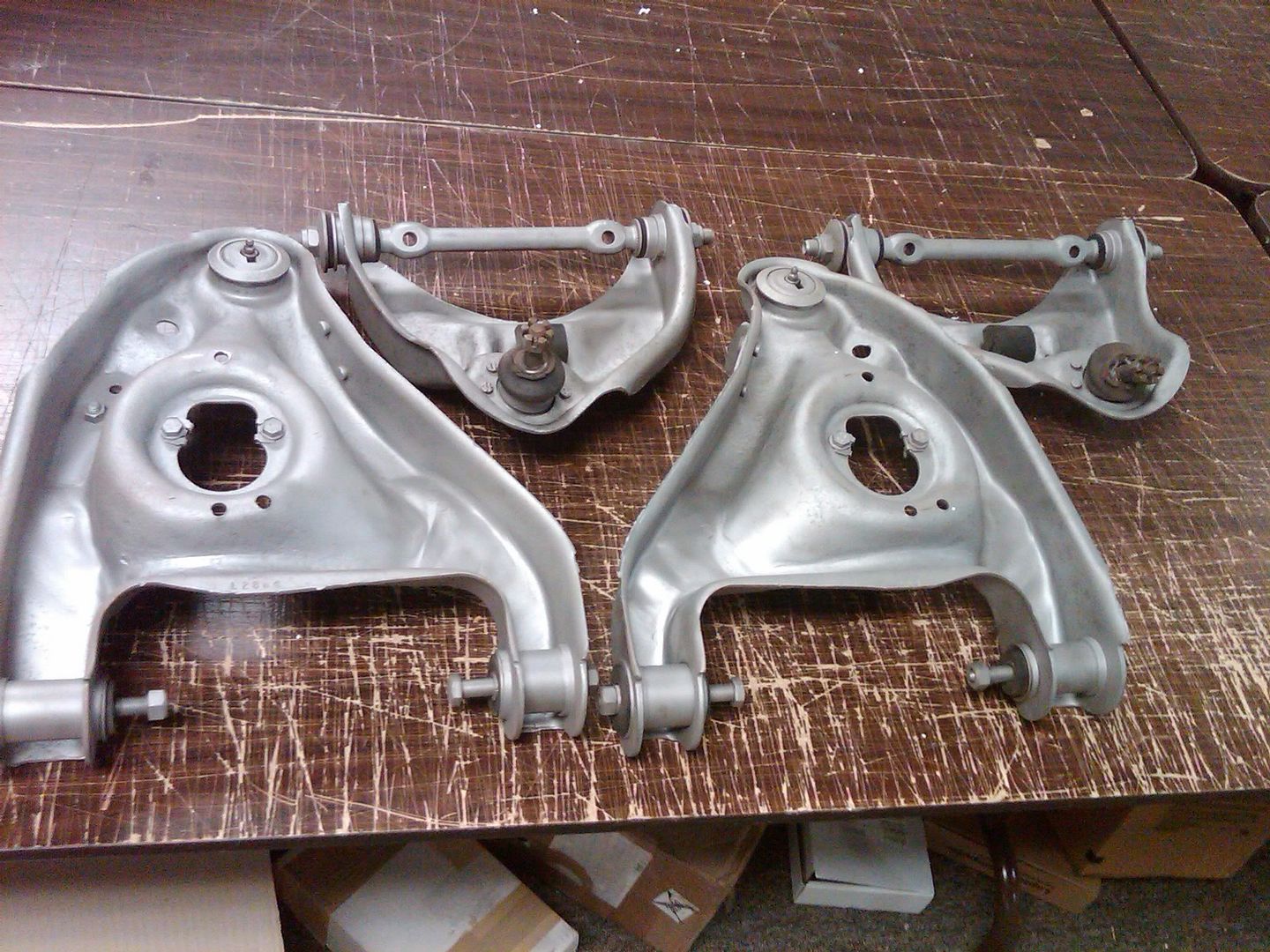

I've been working on the small loose parts this week, getting them blasted and painted.
Today was the day to take these...
and spend several hours in the blast cabinet turning them into these....
I was going to attempt to press out the bushings and drill the ball joints and replace them myself...but on second thought, I think I'll just take them to someone to get them done.
I've got a whole day scheduled to work on the car this weekend, so hopefully I can get the frame finished up and painted. Then I can start bolting back on all of the freshly painted loose parts...

Nice looking arms after the blaster. I did my own ball joints. It wasn't to bad with a good kit. That will look great when done.
