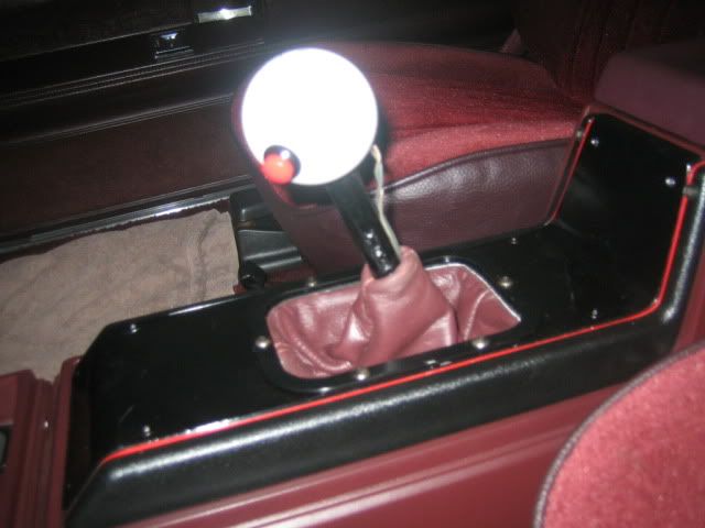

Originally Posted By: Onebadbowtie86
also Ron, I think you change your mind ALMOST as much as me! laugh
ROFLMAO....
The white cue ball looks so cool I just want one.
ROFLMAO....
Make sure to get one with the "red button"......k?
#798523 - 05/31/10 06:49 PM Re: T56 Install question [Re: Houlie]
Posts: 3,071
Posts: 3,071
Small town USA
I like the cue ball a lot....
But wasn't that button just added? How much juice are you throwing at it?
Be a car builder, not a googler!

No juice.....Red Button = Line Lock
