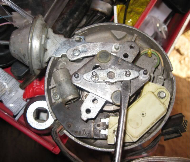

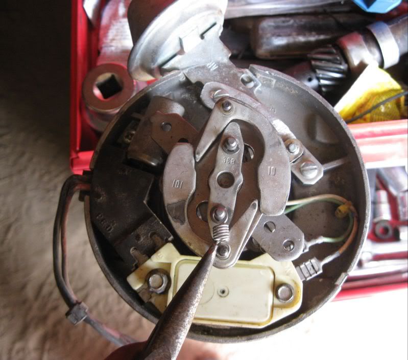

instructions and diagrams are provided but here are some pics so u can get a head start on what it is that needs to be done. first remove the cap and rotor and u will see the weights are held with springs, remove these with some needle nose pliers

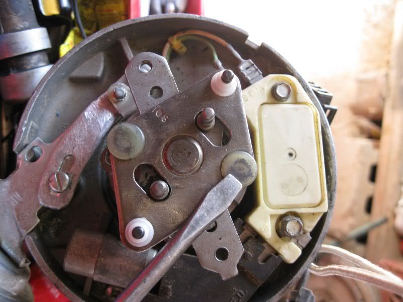

once the weights are off, u will see some e-clips that are holding the center bracket, take care of these clips as some kits dont come with them. remove the clips and pry up on the center plate evenly on both sides until it comes out

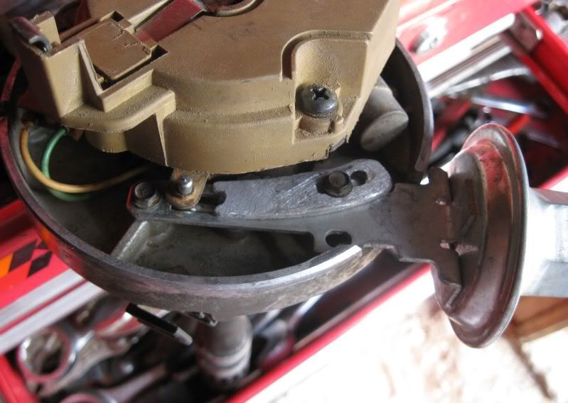

with everything out of the way, you have to grease the tabs im holding, some stock distributors dont have these and have a raised metal section but regardless a light coat of grease to prevent the weights from binding
install the center plate and put the clips back to hold it. from the kit find a set of bushings that resemble ur old ones and put them on the weights first and then on the studs. u can see the other bushing to give u an idea on how they go. once u put the weight back in, go back to the kit and try a set of springs, i went with middle strength first.

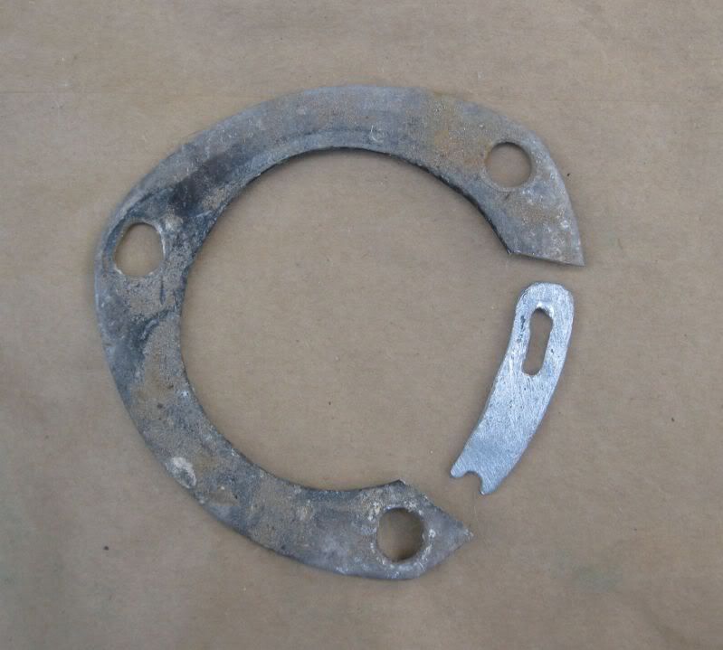

now going back to the vacuum advance, the vacuum advance is the little canister sticking out on the side of the distributor with a vacuum line to it. the purpose of the vacuum advance is to improve idle, mileage, etc. so it makes sense to hook it up to full manifold vacuum. since there is no vacuum at WOT it wont affect total timing only at idle. if you have one of those 20-25 degree canisters (most common) then u will see your timing has gone way up when you hook ur vacuum advance. the vacuum advance has a rod that moves forward advancing the distributor, we have to limit this movement in order to keep it from advancing. below is a stopper i made from an aluminum header gasket i had laying around. smirk
u will noticed it has a notch on the front for the rod and at the back it has a long slot where u can move it up/down limiting the movement of the rod which will affect how much it advances

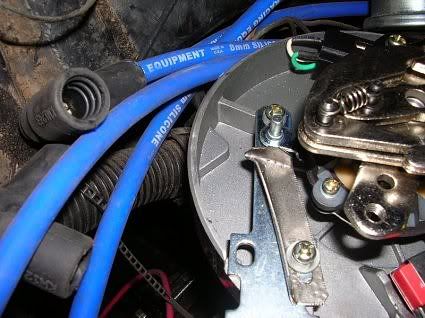

here is another one but u get the idea as to how they work, only thing u need to worry is making sure it doesnt hit anything inside, but the HEI distributor has plenty of space
