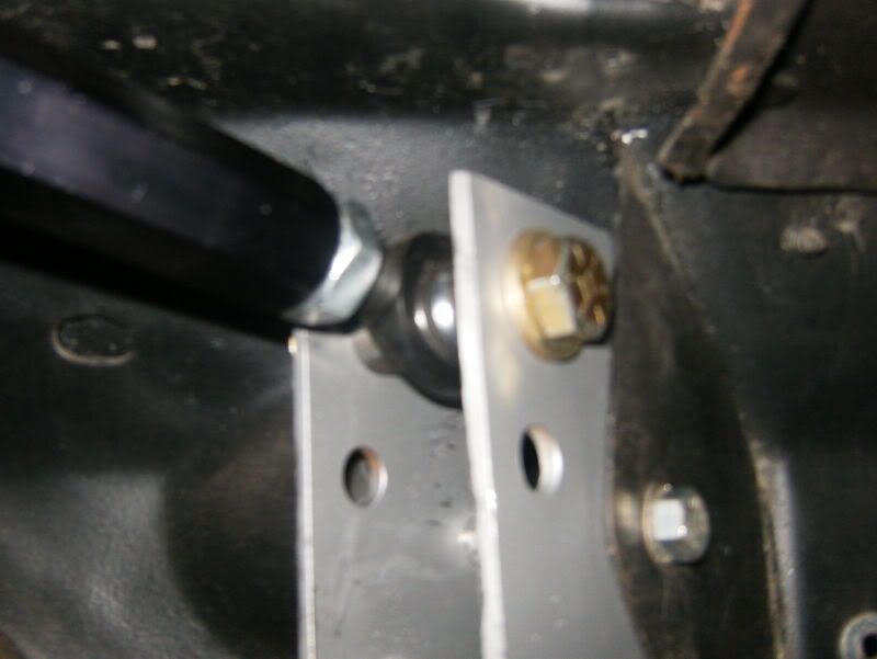

Notice how the rear axle is too far back. That's from the LCA relocation brackets and the adjustable upper arms (set to the correct pinion angle)
I need to fabricate some adjustable lower arms to bring the axle back to where it should be, and then I'll still have the roll steer issue.

Not sure if its covered yet. But I made a u shaped bracket that could be bolted to stock upper mount, Then installed adjustable coilovers. QA1s can be leaned so they fit factory location, spring clears top and bottom, I can adjust shock bound and rebound, ride height and even swap springs with relative ease. I installed in the front alo just for the adjustabililty on the auto-x.

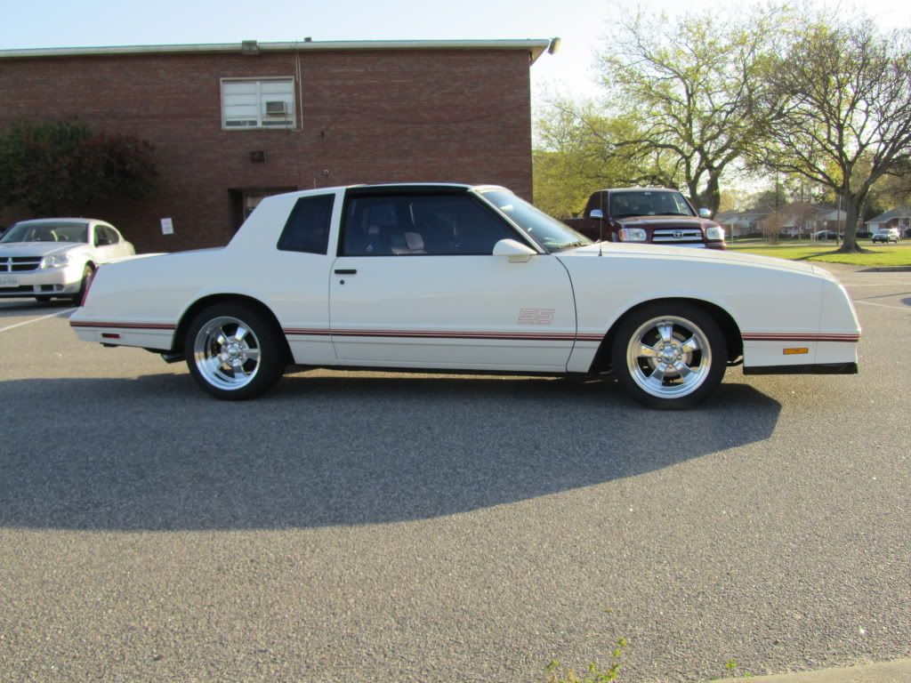

I am done with this portion of my project!!! Total suspension overhaul is complete, along with new Centerline Retros mounted with 245/45/17s up front and 275/40/17s in rear. Nice 2/3 drop with a great stance. I utilized SC&C Street-Comp Stage 2 Plus package, SPC lowering springs, SPC tubular front A-arms, and a new set of Bilstein HD shocks. Hugs the road like expected. Also complete is the addition of Hooker long tube headers (2451-1HKR), true duals, and exhaust dumping out at a 45 chrome tips behihd the rear tires...looks, performs sweet, [/img] and sounds just as good.

I understand your pain with the upper control arms when lowering the rear of the car. It got worse when i put the 9" under the back. The instant center was practically at the rear tires. After some measuring i decided to make some brackets for the upper control arms to relocate them higher. The only drawback if any was the upper control arms were shorter than factory. Here is a partial picture of the brackets.
I still have the issue of a little roll steer, but it is manageable. However in a straight line my 60' times went from an average of 2.0 to an average of 1.65. to me a stick car with that 60' is doing pretty good.

Montec355, I like those brackets, or at least the idea behind them. It's hard to see the execution from the pictures. Is that aluminum?? Putting the control arm there is exactly what my car needs if I was staying with the stock UCA configuration.

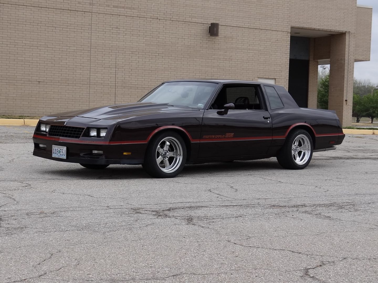

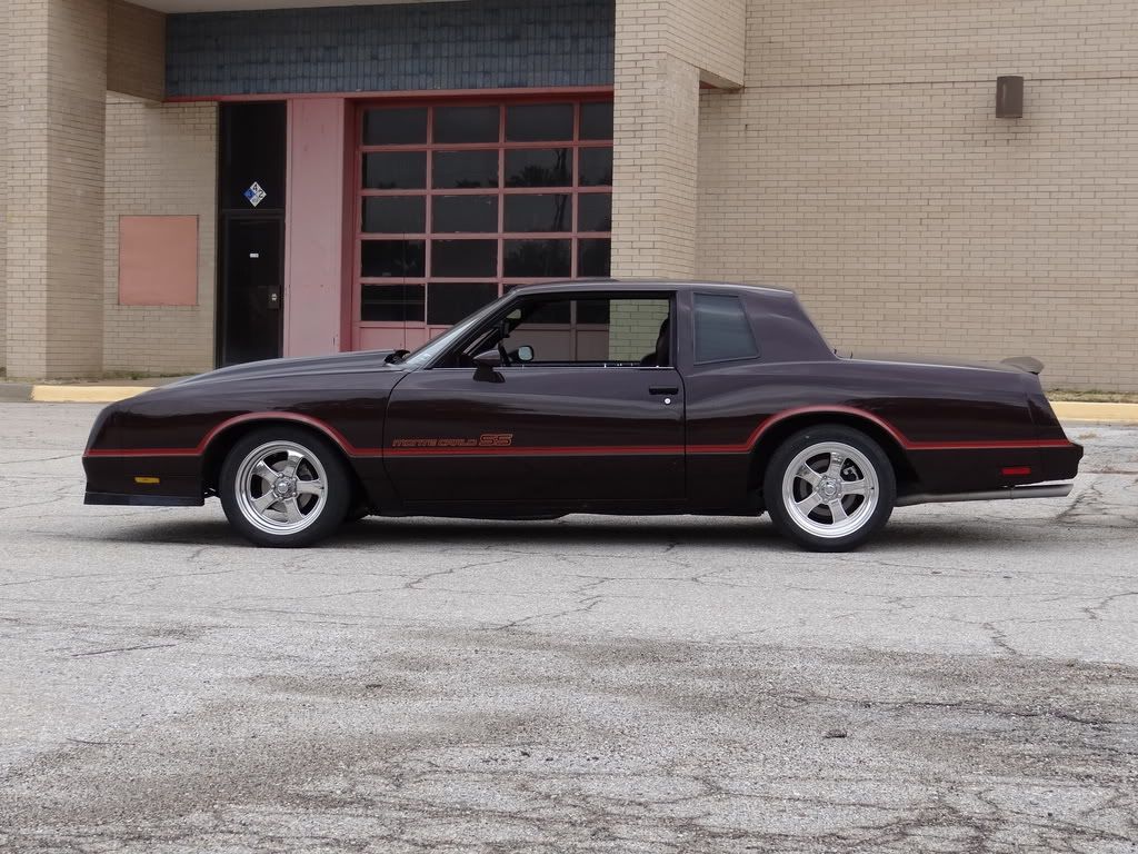

I think a better setup for you would be the Detroit Speed 2" drop springs. They are a 575# spring up front and 125# spring out back and lower both the front and the back approx 2".
Here's what my car looked like with them installed.

Well, I've kinda been all over the board with both of those questions... Should I answer as it sits now or as it sat in those pics from 2 years ago? laugh
The 36mm F-body sway bar is a fine upgrade and works well. I raced with one most of this year in fact. I'm now running a much stiffer Ridetech musclebar...and my car still leans a bit too much on the autocross course.
In that pic above I had 245/40/17s up front and 275/40/17s out back. I've always ran a tire around 25.5" tall which is close to a stock height tire.
I ran the DSE springs for a year or so and they work VERY well. Eric (406monte) bought them from me and has them on his car and I'm sure he'll vouch for them as well.

I'm running Ridetech triple adjustable coil over shocks now so I can adjust any corner of the car to basically any height I want.
I've actually raised it back up some from the height it was at with the DSE springs in order to get more suspension travel for racing.
Took this last week
Front fender lip is at about 25.75" at the center of the spindle and the rear fender lip is at 26.75" with me sitting in the driver seat.

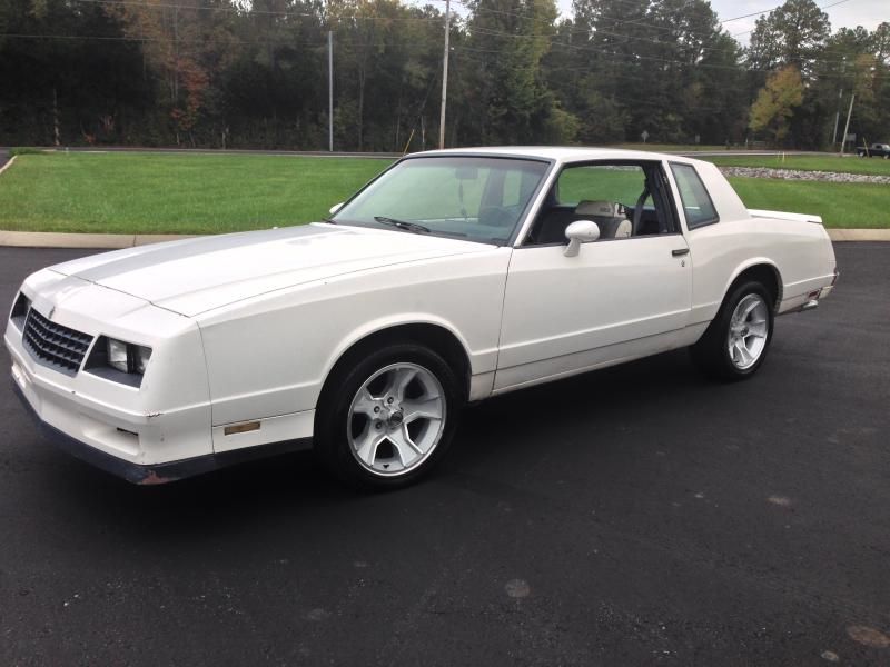

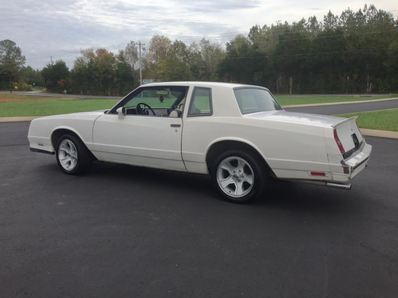

I thought I would comment incase anyone was curious what the 3" drop spring does
this is stock spindles, cut stock spring in the front and 3" a-body drop spring rear, rears are VERY SHORT about 8 or 9" at rest, not sure how they are going to work at the track but I love the stance of the car now.
that's a 275/60/15 in the rear and a 215/60/15 iirc in the front
also it has a bigblock so that probably can attribute to some of the drop up front
