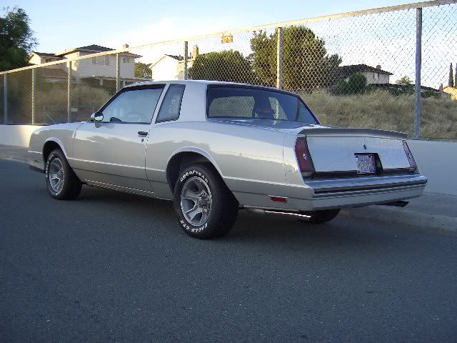

Great photos guys! I wish I had more for the monte but the only one's I have are these:
Turned out straight as a pin when I was done, damn these spoilers haha.
