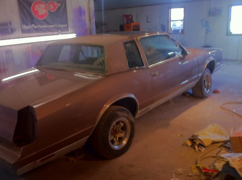

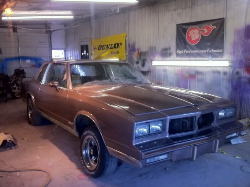

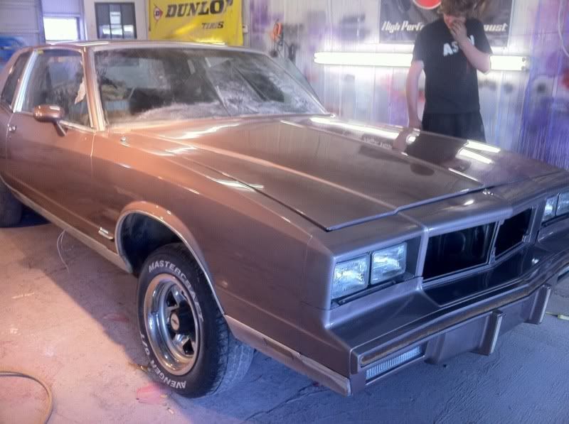

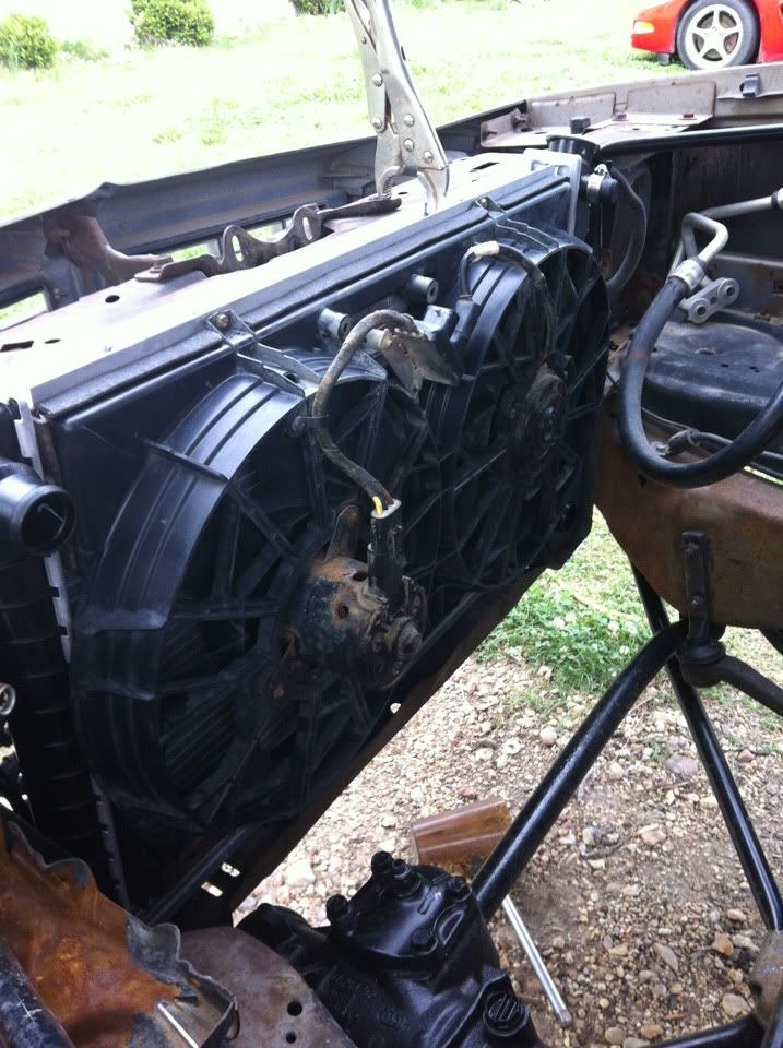

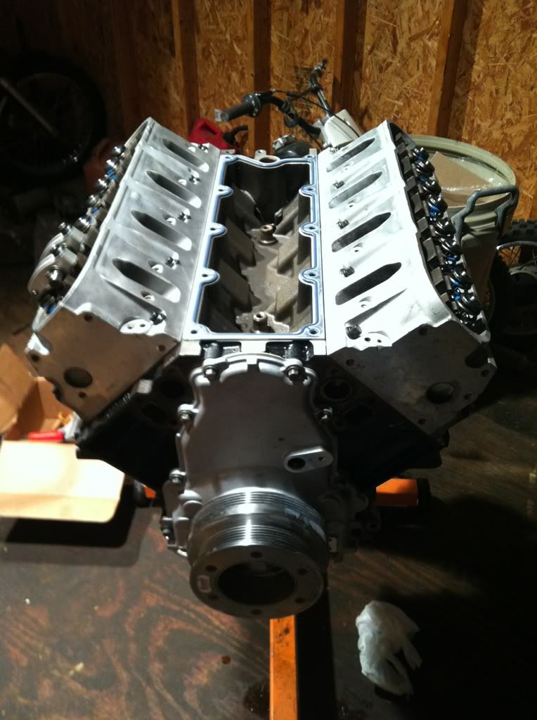

Finally got around to uploading the pucs so I thought I would share a few. An hopefully I post all the info correct!!
Here she is after the paint job an before anyone ask yes I have full plans of putting the 1/4 vinyl top back on an the wheels will be the 15" steel rallys on 245/60r15 Cooper Cobras.
Fans Installed "Dodge Intrepid"an part of the new suspension parts"all new Moog pitman arm, ball joints, control arm bushings, center link, idler arm, ball joints, tie rod ends, MCSS steering box, Eibach Springs with Bilstein shocks.

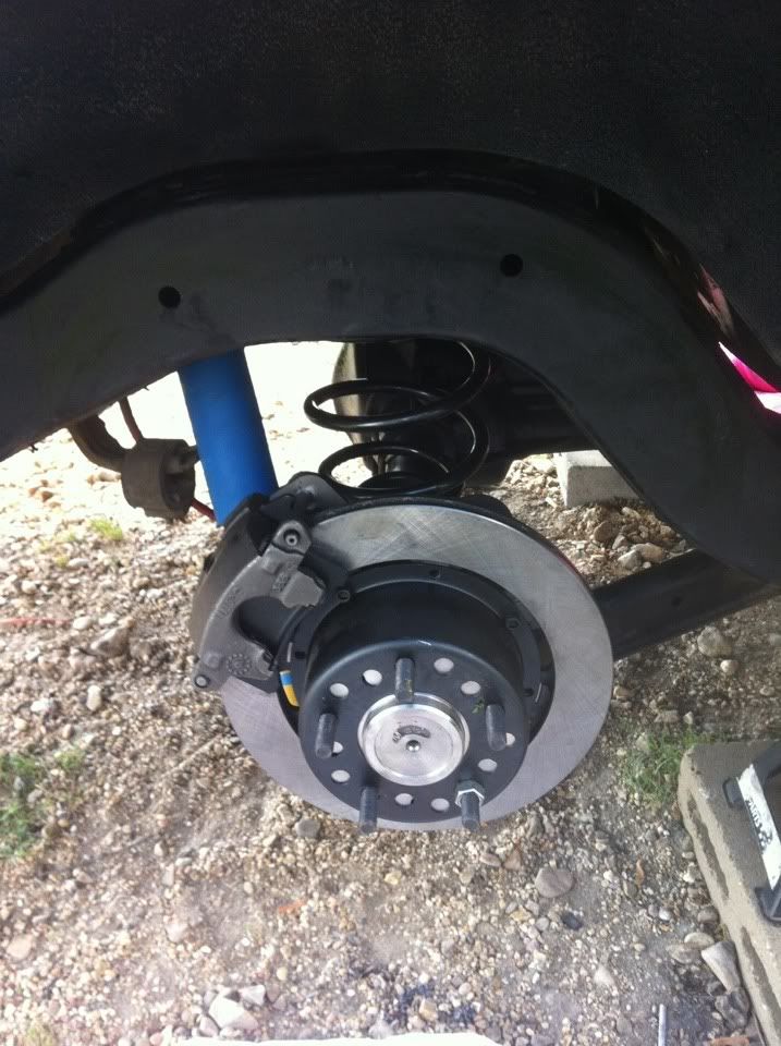

Rear Disc Brakes with GN 8.5" rear end filled with new 3.42 gears an Auburn Posi an 30 spline Moser axles.

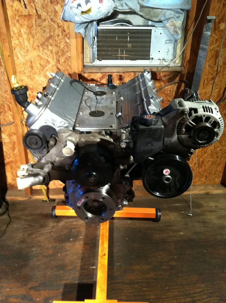

Long Block 5.3 bored to a 5.7 with Mahle forged Pistons, Arp Bolts everywhere, Custom Comp Cam 220/224 .581 113 lobe, Comp Cam pushrods, LS7 lifters, Set of 706 heads cnc ported flow around 320@.650 with 2.02/1.06 valves, Summit Underdrive Pulley "picked this up cheap new on craigslist"
Pic of motor with C5 Corvette Accessories

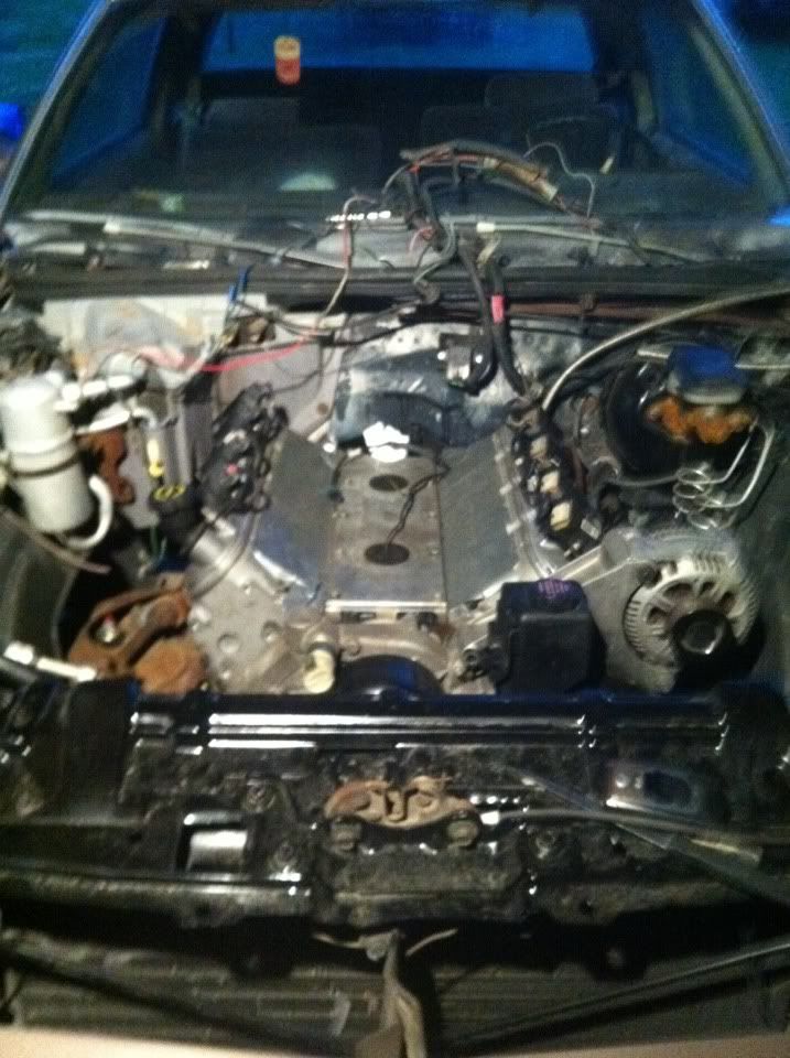

Motor installed in the car finally
4L60E Transmission transformed to a 4L65E: 3600 Yank ST convertor,5 gear planateries, Corvette C5 valve body an servo, TCI bands, beast basket, new gm clutches an other misc parts "honestly I don't know I ain't a transmission guy lol"
Fast 78mm intake with LS3 42# injectors "not shown"
Currently I'm waiting on my height adapters for the injectors to get here they should arrive tomorrow an my new coolant bypass lines should be here Tuesday an hopefully I can wrap up everything with the motor. The transmission an driveshaft are in just gotta do some work on the shifting mechanism since I wanna retain the column shifter. Pretty much from here I just gotta get my buddy over an get him to do his wiring magic on it then get the exhaust work done, tires on the vinyl top installed an get the tune dialed in. Our planned date is June 13 so I can hand her over to my daughter for her 16th Bday present. Man this has been alot of work!!!

Well te car has been up an running about 2 months now with only very minor issues. All in all were very pleased with the way the car came out an my daughter absolutely loves the car an all her friends think the car is so cool! Who would have thought 16 year old kids now days would respect an old plain Jane car like this. Her car has been the talk of school when the boys go to talk about racing she says everyone says if you think your bad go get a piece of Mor's "my daughter" Monte Carlo. An everyone declines lol.
I've logged quite a few miles driving it myself an the car handles very good, brakes are awesome an the power is stupid it makes my '02 Corvette feel like a V6.
We took it to the track last sunday there was a huge turnout but we managed to squeeze in one pass. I launched it about 1000 "it will stall 3000 on street tires" it instantly started spinning on launch. I completely lifted got back in it again it hooked for a brief moment then spun all the way through 1st spinning so hard it missed the shift an hit the rev limiter. Once it got into 2nd it chirped the tires the rest of the way down the track. Still after all that it ran a 1/8 mile 8.65 with a 2.21 60' not to shabby for cooper cobras. After I made the pass several people came up an wanted to know what size shot I hit it with.
I will be picking up a set of drag radials this week an a buddy is gonna let me borrow his 15x4 front runners an if I have the funds I will be picking up the last needed piece for the nitrous system a Harris speed works plate. If I can hook it an hit it with a 150 shot I'm almost sure we will have a 6 sec 1/8 mile car that is a daily driver full body car with power seats, windows, locks an air conditioning and on top of that gets about 25 mpg on the highway.
