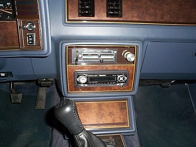

I am running a T-56 6-speed out of late model IROC. To make it work with the early motor (1978 400 SBC out of 3/4-ton K20 4X4) I had to use a Centerforce 36 lb flywheel specially made for mating the T-56 to the early motors (it is a shelf item though).
I used the clutch pedals out of a 1993 F-body using the hydraulic 'pull-style' setup. I had to shorten the driveshsft 1.5" to use with the sock rear.
Everyone that has a Monte and never drove a manual Monte is missing out on all the fun... plus the 50% 6-th gear overdrive drops my RPM's to about 1600 and you can just guess at all the savings in fuel and wear and tear!

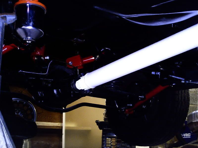

4" aluminum driveshaft 49.5 inches long, bought from Tri5ss here on the site(THANKS JOHN!)
