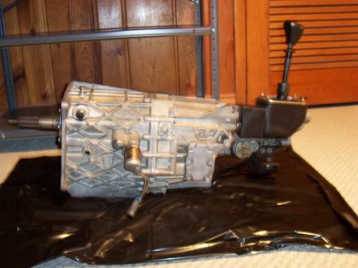

 Originally Posted By: Dalt10
Bernie, What's the deference between the Corvette ZF 6 speed and the T56? I can get the Vette ZF alot cheaper than the T56. Is it alot bigger? Is that why you had to cut the trans tunnel?
ZF's are pretty strong out of the box compared to T-56, but the problem is that nobody knows how to work on them. They also have an incessant growling problem and its pretty hard to find a used one in good shape. I've read that if the clutch pedal does not FULLY disengauge between shifts, you end up with alot of problems too, apparently the vette guys have problems from that.
I dont know if its bigger... mine was about 100lbs dry. The main problem is that the entire body of the trans is offset to the driver side of the centerline that passes through the input/output shaft. The C4 ZF's are not transaxles or "remote" transes. You just need a custom flywheel if you run a two piece rear main. Not sure about a one piece, the transes come off of LT1's. The McLeod flywheel that I have cost about $600 from what the prev owner told me, and thats for a single mass. Apparently they are "supposed" to have dual mass flywheels.
I'd love to see where you are finding ZF's cheaper than T-56's so I can pick up a spare. The last one I saw in good shape was a blue tag (not as desirable) and it was $1300. I found a black tag with a blown reverse for $400 that I might be able to have my reverse put into if I ever needed it, but teh labor would probably be rediculous. Those prices are for just the trans, no bell or anythign else
Here's mine
