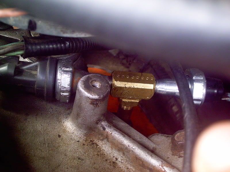

i need to know if this oil sensor is needed if u dont have a computer
i used a 'tee' to attach my oil pressure gauge sensor to the other one, but it keeps leaking oil through there.
can i remove it and install my oil pressure gauge sensor in it's place if i dont have a computer or do i still need to keep it
thanks
#511329 - 12/11/07 03:28 AM Re: Removing the Monte Carlo SS computer [Re: jigsaw]
Posts: 12,857
ss4ever Offline
ss4ever  Offline
Posts: 12,857
Shelbina, Missouri
The two prong sensor was for the choke, would only let power through to the choke when there was oil pressure so that the choke wouldn't open up on it's own if you left the key on.
You can ditch it just make sure you run a wire to the choke that is not interupted by the pluggin for this sensor.
