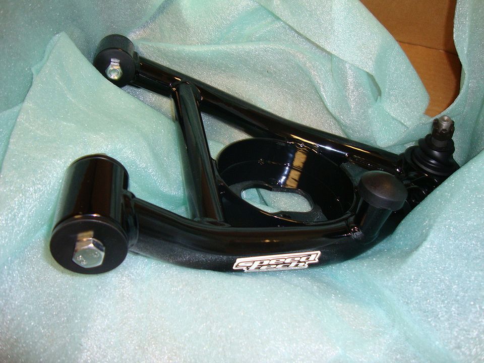

Found this today for the frame, I hope it makes a difference??
[img]https://hosting.photobucket.co...=960&height=720&fit=bounds[/img]
Joined: Feb 2020
Posts: 1,087
Likes: 22
Joined: Feb 2020
Posts: 1,087
Likes: 22
Is that the hellwig kit?
Posts: 3,401
Likes: 8
Posts: 3,401
Likes: 8
Yes it is, I had bought this a few years ago when I started hoarding suspension parts from speedtech.
