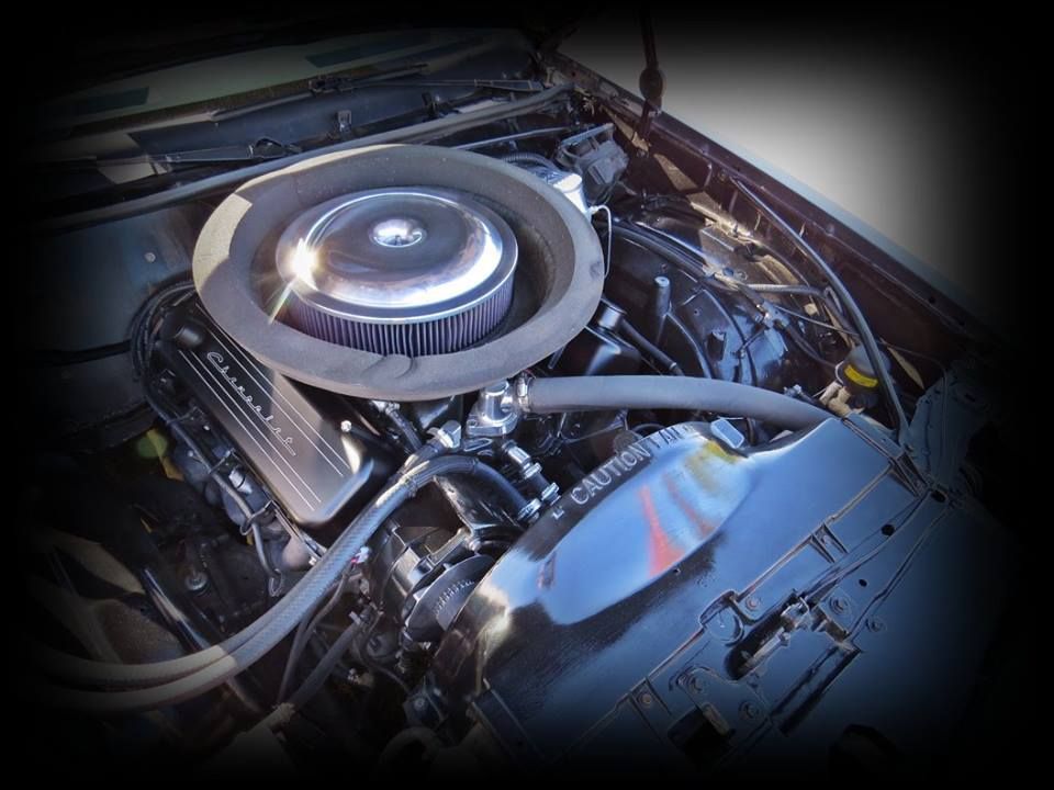

I just recently did some upgrades to my 30,000 mile stock 305 in my '86 SS with great results. I went by a 305 build I did a few years ago for another project. I used a Lunati High Efficiency 272 cam (.454" lift, 217/217 duration @ .050", on a 112 LSA). I also used my stock CCC system and stock torque converter. I'm running Hedman Elite full length headers with a X-pipe and custom exhaust. I did a 1228079 ECM swap with a custom ZZ4/L69 chip by member BitFlipper. Stock ignition, but used a Hypertech street/strip coil and Taylor StreeThunder wires. Now, I've been playing more and more with the timing lately and this cam tends to like a lot of it. I have it currently set at 12 degrees initial and it really runs great. If I was rebuilding the entire engine, this setup would be great with a set of flat top pistons and a set of Vortec heads that I've used in the past. Right now the stock heads are at a disadvantage, but the car is a night and day difference from what it was. No engine codes, no adjustments to the carb, and all power accessories work perfect since this cam makes great vacuum. And did I mention it sounds killer with a definite noticeable idle, but yet almost looks completely stock under the hood.
