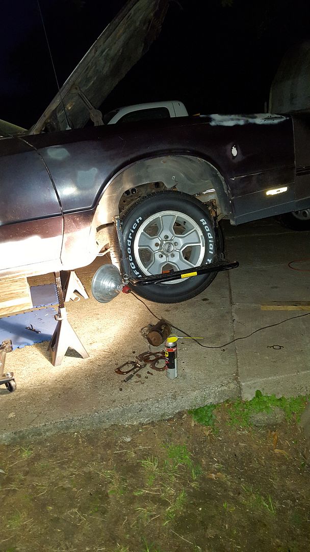

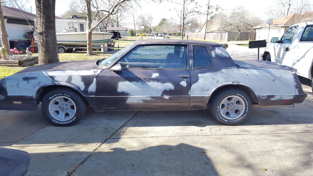

This should be day one after I put tires on it:

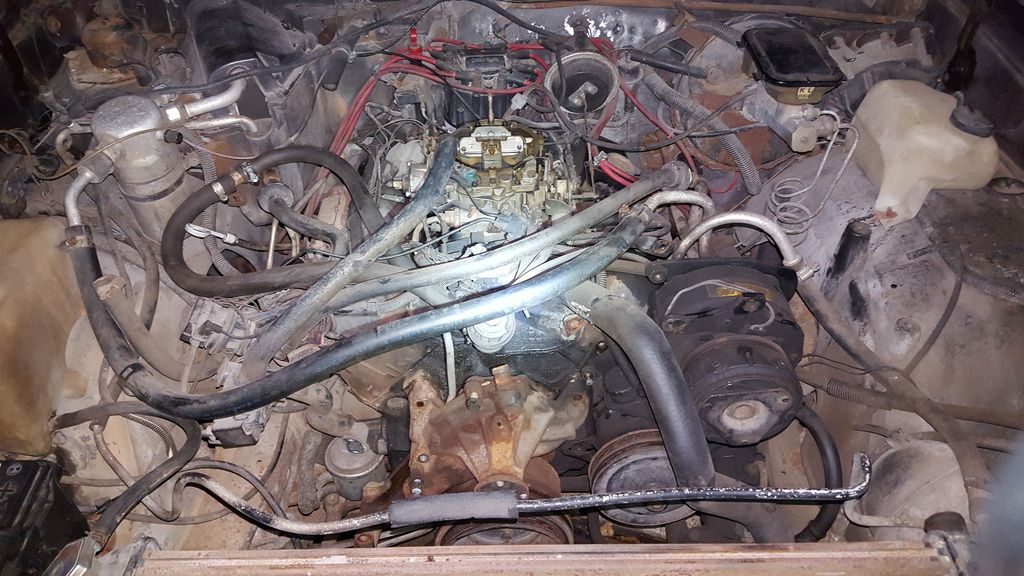

This is what the story was under the hood:

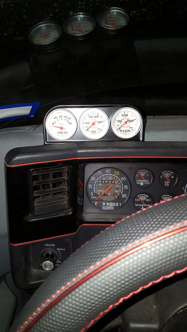

Here are the guages to replace the non working dash gauges:

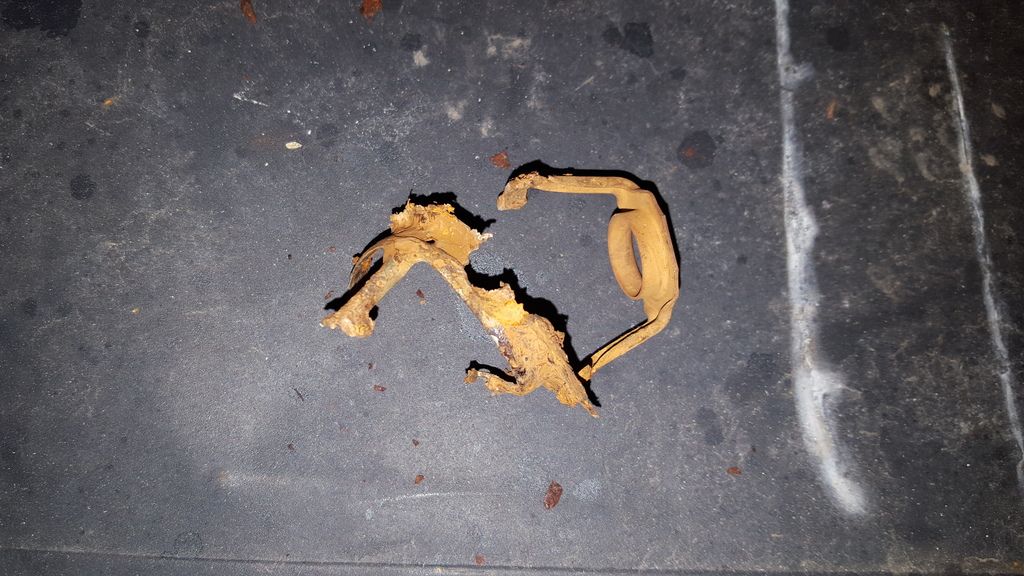

Here the thermostat I pulled out:

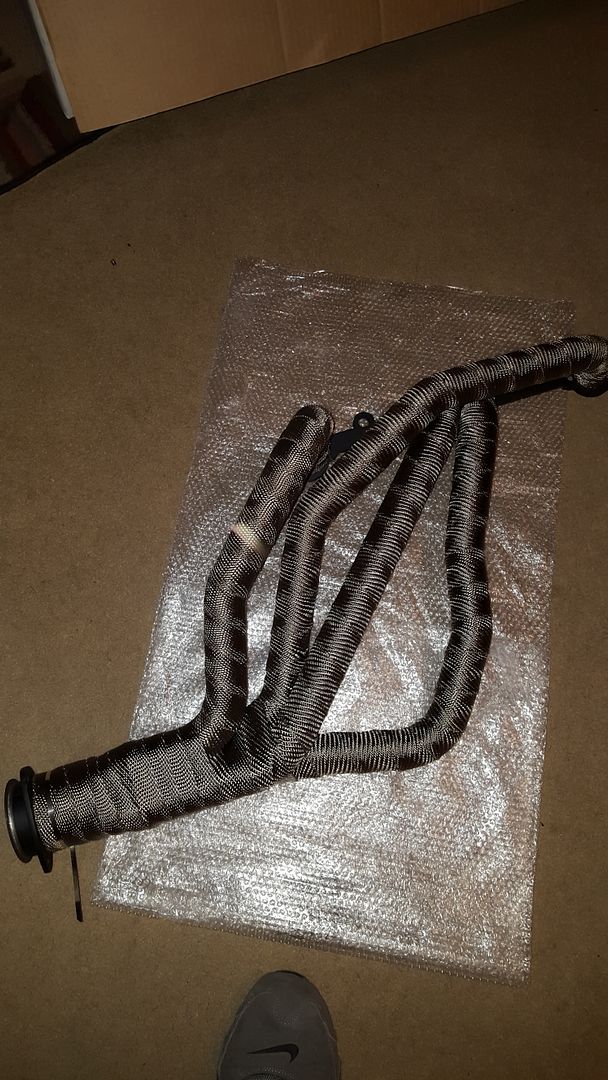

And here's the passenger side wrapped header, and the car lifted and almost ready to install passenger side header:

The exhaust was a bit of a tricky situation. I ordered a 2-1/2" header back with no mufflers, and used the old mufflers from the oem exhaust. When jegs put together the package they sent a brochure, but no instructions. So I winged it, and now the exhaust is dumped directly behind the mufflers.
Just a tip for anyone planning on changing manifolds for headers: the ac compressor bracket that bolts up off a stud on the drivers side. Yeah it won't fit over the new exhaust primary. I did some modifications because I'm on a pretty strick time line. But they sell adapters, and I would recommend this highly, especially if you don't have the tools to fab the correct geometry into the new homemade bracket.
Also recommend thoroughly thinking the process through before purchasing headers. Not only are they time consuming to install, but there are sometimes a few things that need to be relocated. The oil sending unit on the drivers side is one of these items, the starter is a tight fit, and most of the spark plugs had to be shorties, and tightened with a wrench.
