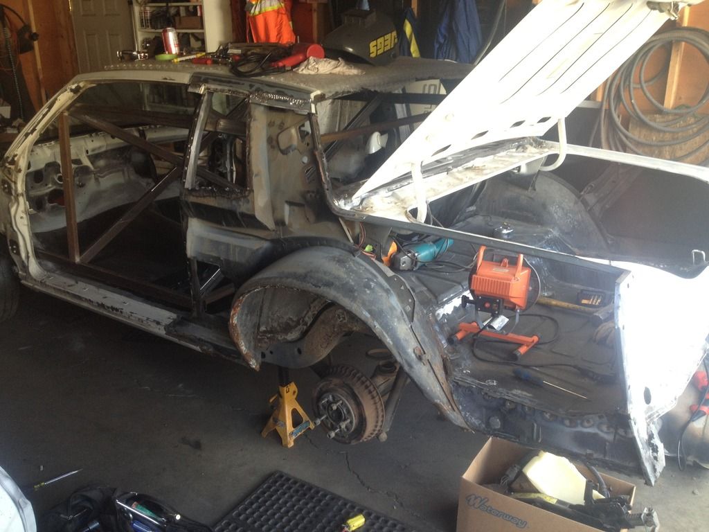

I was wondering if I bought the left and right side separate and left the trans tunnel in tact if it would be easier.
yours looks great and mine is in about the same condition as yours was before.
I was just thinking that it might be easier for myself because Im not much of a body repairman.

The aftermarket quarters have the whole quarter window in them and the seam is just above the window, at least the ones I have are that way.
I think you'll also need the rear window out as the quarter wraps into the window seam. One other thing to address is you'll have to reapply the studs for the window trim moulding, they can be welded with a stud gun(which is what I'm going to shoot for) or I think you can get the ones that have a screw that holds them.
When the weather gets nice enough I'll be doing the doors and qtr myself.

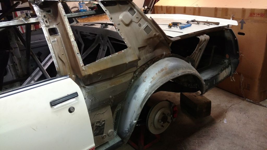

I dont have much more of a pic of the OEM qtr seam but it comes across to the window and is the outer most layer on the top of that window recessed area.
Here is the new qtr that I have not sure if the new ones are the same although I would suppose they are.
Hope that helps some.

Cool thx for the pics. The panel u have can u send a pic of the back window flange area . My panel will be same by your pic and mine I'm getting. How did u get the lead off ?heat it up and scrape it away . Thx i have been doing it by chipping it and digging away at it

if you use a torch the lead will roll out of the joint, just dont overheat the roof panel. I'll get that pic later today.
I just re-read my pic post and I think I wasn't very clear. The roof skin comes down to the quarter window opening and it is the outer most layer of the top window lip. The quarter panel is the next one under that I believe.

Thx . Ya i have the seams figured out and how I'm going to install it. If u notice in your window well area on the top roof section ,the flange is part of the roof as well. Quarter slips under that. If my quarter is like yours I will be modifying the above window area on the new panel so it slides under just like the factory one . Cleaned the back window flange last night . the quarter should have a flange for the rear window channel where the window clip studs are . That sealant for the rear is a pain . Side window came out and the sealant came off by just grabbing it and peeled right off . Have good day smile

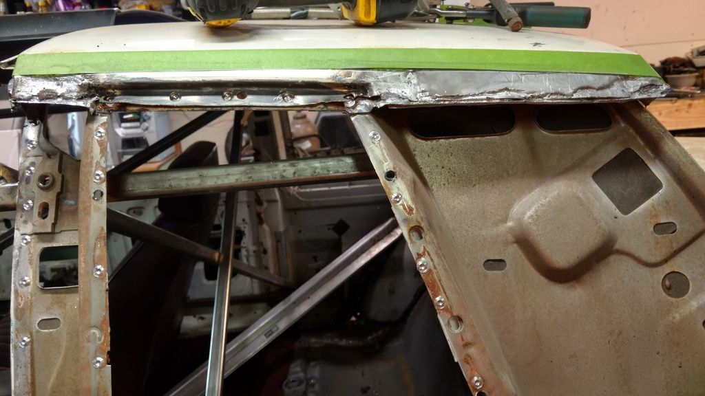

This area in comparison to the panel u have. I marked the seam with yellow pen.

That looks pretty close to where the repro flange is for length...

Thank you for the time to show that pic . Settles the nerves Lol been working hard at trimming pan and exposing the quarter seams . I have a month till the quarters show up so want to get floor done by then not to long now

I recommend welding the seam shut in the corner of the quarter window frame. The large factory gaps there cause a lot of flexing and cracked filler.

Thanks i was thinking to weld that area . Will look at that once I install the quarter . Mine was cracking like a hair line crack. I WONT be replacing the lead with plastic filler . Read other members stating that it is like a sponge and will retain moisture.Any one use it . What is best to replace the lead with so it look right and doesn't crack in the future thanks

This is the only pic I have now
Under the original qtr there is a support on the seam. With the reproduction qtr the seam will be a bit higher, I'll try to get a better pic of what, I think, I'm going to do.
I do like the thought of no seams in the qtr window flange.

I think I'll cut just below the tape and remove the outer layer first, which is the roof skin. After that what's left of top flange of the qtr window is part of the original qtr so I'll try to save that to butt the new one against.
I think with the roof skin off I might b able to fit the qtr up there a check fit or lack thereof.

Quarter is off now . Working on the trunk area now . Almost have the spare tire well removed then removing trunk floor as well. Will be getting the complete trunk floor with braces and spare tire well . Then wheelhouses then doors . Slowly but surely . Just gotta keep it one day at a time wink . As you can see the trunk isn't to bad but the driver side body mount brace and part of floor where it meets the wheelhouse has some rot . Soon will be nice and new metal

Boy that looks familiar think
Sorry I have just the passenger side lower a pillar I went through my scrap but didn't find the drivers side. Check with Mick he's cutting up a car right now I'm getting a patch panel from him.
The drivers trunk floor fit pretty well in mine just trimmed a minor spot by the spare well. I got mine without the body mount and wasn't expecting the fuel tank braces but to my surprise they were there. The only spot it don't fit well is around the filler neck but it should be easily fixed.
Looks good keep at it your motivating others whiteside

Hope these links work .some update pics.gettin to the trunk on the 84
https://ibb.co/jCeuOb
https://ibb.co/dCKiGw
https://ibb.co/nz129G
https://ibb.co/mH263b

Anyone check the links .last post is the trunk floor fitting

So i picked up a donor frame for the car .was from a 84 ss which was awsome since mine is a 84 as well.paid 500 and its completly redone .no fixed body mount holes or anything like that.frame rails have been boxed and lca and uca have been braced .its coated in por15 insode and out .i figured it would cost me alot more to have the 84s frame at this point so it was a no brainer .trying to post pics

https://image.ibb.co/dfCsfy/20180520_110856.jpg
Frame also has driveshaft loop brackets .might be hard to see the mods .i will post some more pics
