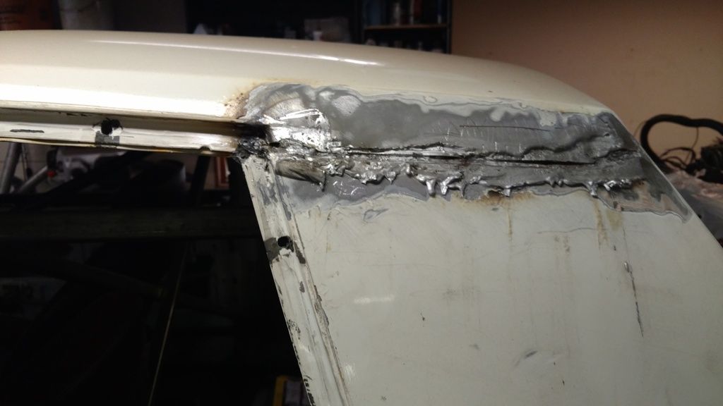

The aftermarket quarters have the whole quarter window in them and the seam is just above the window, at least the ones I have are that way.
I think you'll also need the rear window out as the quarter wraps into the window seam. One other thing to address is you'll have to reapply the studs for the window trim moulding, they can be welded with a stud gun(which is what I'm going to shoot for) or I think you can get the ones that have a screw that holds them.
When the weather gets nice enough I'll be doing the doors and qtr myself.

Thanks for the kind words guys. Markg this is my first time doing the floor . I honestly think its easier doing entire floor . Plus less welding . Ls1 monte I have removed rear window last night before reading this . What you suggested I already figured lol. Thought about the studs for the trim as well . I will prob get the shop that is doing the paint to stud weld all of the window studs back on same with the front . Window came out pretty easy with a heat gun and 90 deg pick . All glass is coming out body will be totally stripped down . Just ordered both full quarters , seat mount square mount pads , and floor plugs. Need a better way to remove the lead from quarter seams any ideas thx . Ls1monte can u send me a pic of the quarter mainly the upper flange. That should be the factory seam like in the pic. This is my first rebuild as far as body and love it !

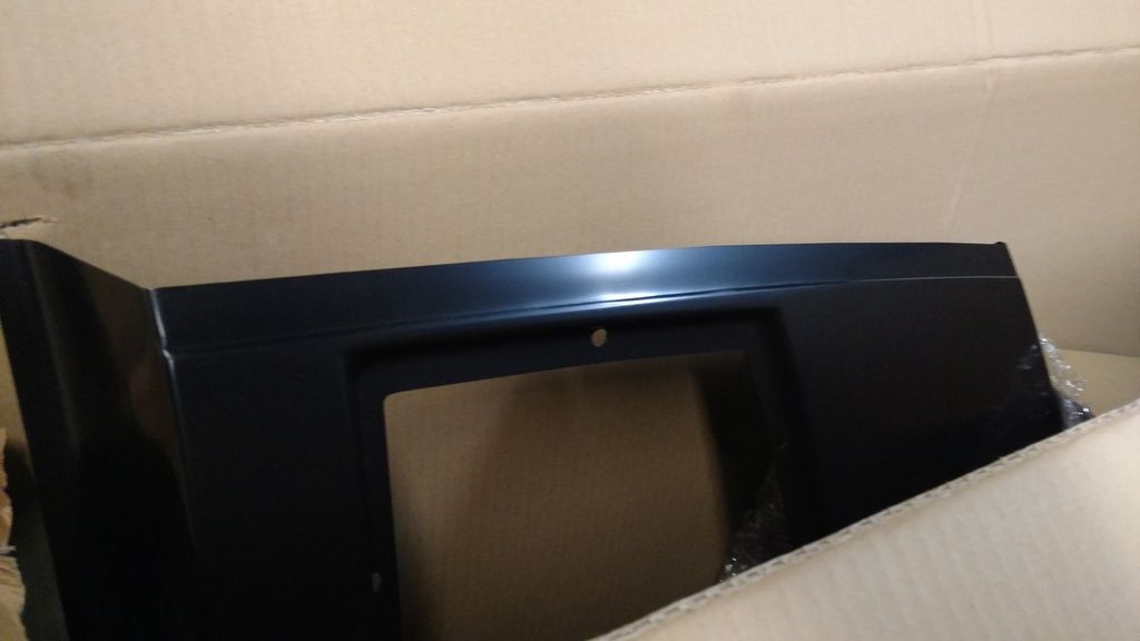

I dont have much more of a pic of the OEM qtr seam but it comes across to the window and is the outer most layer on the top of that window recessed area.
Here is the new qtr that I have not sure if the new ones are the same although I would suppose they are.
Hope that helps some.

Cool thx for the pics. The panel u have can u send a pic of the back window flange area . My panel will be same by your pic and mine I'm getting. How did u get the lead off ?heat it up and scrape it away . Thx i have been doing it by chipping it and digging away at it

if you use a torch the lead will roll out of the joint, just dont overheat the roof panel. I'll get that pic later today.
I just re-read my pic post and I think I wasn't very clear. The roof skin comes down to the quarter window opening and it is the outer most layer of the top window lip. The quarter panel is the next one under that I believe.

Thx . Ya i have the seams figured out and how I'm going to install it. If u notice in your window well area on the top roof section ,the flange is part of the roof as well. Quarter slips under that. If my quarter is like yours I will be modifying the above window area on the new panel so it slides under just like the factory one . Cleaned the back window flange last night . the quarter should have a flange for the rear window channel where the window clip studs are . That sealant for the rear is a pain . Side window came out and the sealant came off by just grabbing it and peeled right off . Have good day smile

This area in comparison to the panel u have. I marked the seam with yellow pen.

That looks pretty close to where the repro flange is for length...

Thank you for the time to show that pic . Settles the nerves Lol been working hard at trimming pan and exposing the quarter seams . I have a month till the quarters show up so want to get floor done by then not to long now
