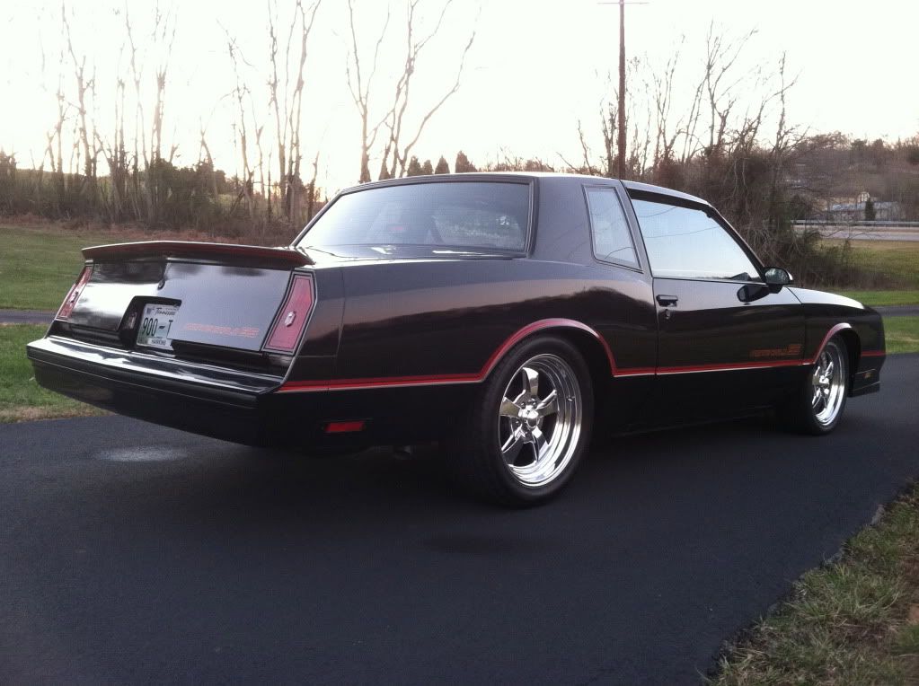

Here is my car with the CPP A body springs in the rear
http://sickspeedmonte.com/ProShot.bmp
I don't know what the rate is, but I might be able to measure it at work...

Hi SSM,
Great picture!
Everyone - in general, fractional changes to front spring stiffness should be reflected in the rear too. So if we increase the front stiffness by 50%, then the rear should go up 50% too, etc. IIRC, the stock front/rear spring stiffnesses go in a ratio of about 3:1.
I love the stance but as I stated in the rear lowering thread im more concerned about the effects of roll steer in the rear to go that low. I keep asking smokin86 about what his setup is but havent gotten any information from him as I plan on running 18x8 and 18x9.5 Coys C5's.
