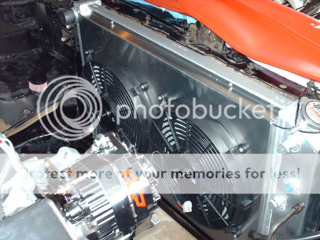

I gotta say Ulli, thats a pretty slick setup.
Which fans are you running it with?

The fans came with the Radiator I bought . Itís made by Champion . Iím sure theyíre nothing fancy or expensive .
Shroud extra

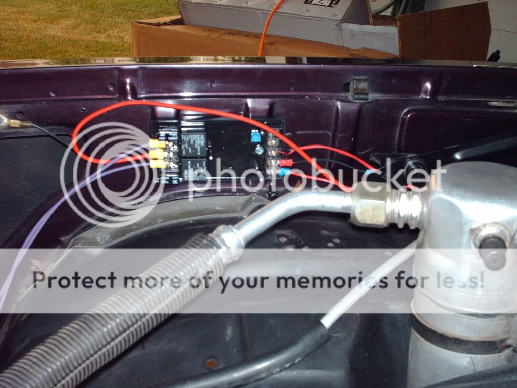

The fan control works pretty neat . Quality , adjustable and ease of installation caught my eye . The less you pay , the less features you get . I looked for a while before I chose this one . After this price range you were spending money with little , if any gain Ö. IMO . Thereís always the thought of problems with electric fans over mechanical . I think I got it right . Weíll see Ö. LOL .
Tony ,
This is picture when I was installing it and testing it . None of the wiring was permanent in this picture , but you get the idea .

So all you had for wiring was the plugs off the fans in the picture and the Jegs controller?

I cut the plugs off the fan and hard wired with supplied wires that came with the control unit . The controller came with everything needed to do the job . The only thing I was on the fence about was the dry sender . I was thinking it might not read as accurate as the wet . It ready doesnít matter . When you set it to come on , thatís when it will come on regardless if itís 185 or really 182 . Iíve only put a few hundred miles on the car , so I canít say itís the best or if longevity is there or not . The thing I was looking for was a complete unit . I wasnít interested in adding this or changing that . This it a plug and go unit . So far it works as advertised . I havenít tried the A/C , to see if it over rides and kicks on the fans , I will admit that . They make a bunch of different types and styles . I was starting to over think the whole thing . Like I said , I hope I did the right thing Ö.

Washington, MO
Ulli,
Did you test your efan control unit anymore? I just read the install instructions. Did you run a wire to the starter post? I was thinking maybe I could run that wire to the battery instead?
