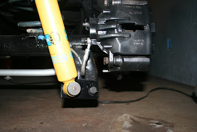

Go to my CD site. I did this swap.

The rears may clear 15 wheels. My fronts will not.
If the caliper was at the 3 oclock position the shock would not have been moved inward. It barely was in the way at 9 oclock.

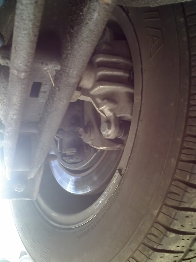

Originally Posted By: axisg
-As stated above if you clock the rotors in the stock fbody location ( 3oclock ) then you don't need to re-locate the shocks.
3 o clock on which side? I think a lot of this might have to do with the shocks you're using - there was no way mine were going to clear once the banjo bolt was installed, and I didn't see any way to clock them at all. Do you have a picture of yours installed? I even switched sides for the backing plates, but nothing I could do would clear the shocks.
Here's my passenger side, with a relocation bracket I made (it's T shaped and goes up the control arm) and where I welded the brake hose tab:

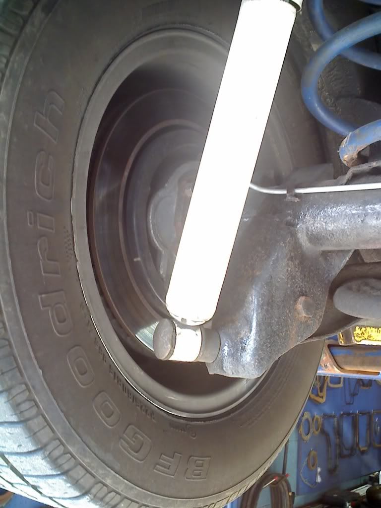

-Some recommend changing out the MC for a disk/disk unit ( something else I have not done )
I gutted mine based on a directions I found for a Baer kit online. Haven't driven the car, so I don't know how well it works yet.
This is a pic of the inside rear drivers wheel. The calipers can be mounted forwards of the rear axle. You can also see how little clearance there is with the 15" wheel

A good page to check out is http://www.thirdgen.org/ls1reardisc and the monte-list page(unfinished) http://www.monte-list.com/tech/reardiskbrakes.shtml
The two issues with installing the LS1 brakes on a A/G is as shown, either the rear shocks are in the way, or the sway bar mounting bolts are in the way. The latter seems to be hit or miss. IMO the factory rear sway bar is just a snap oversteer device anyway.
As for wheels, not all GM 15" wheels will clear the rear calipers.
The large raised bridge will come in contact with the center section of some wheels, or if the hoop has a large radius up to the center section(83-87 15" Olds SSIII). I tried two different 15" GM steel wheels. One cleared fine but the others center section would catch. Some '70s 15x7/15x6 Pontiac Rallyes cleared, but watch the weld bead at the hoop to center section. I had one rim that had a sloppy weld blob and it would just graze the caliper bridge.
-Michael

The two issues that seem to be the problem.
Sway bar bolts with the nut facing out and the bolt shank coming into contact with the caliper. This can be rectified by simply flipping the bold to have the nut on the inside of the RLCA. Or removing the sway bar.
The second was the banjo bolt head/banjo hose end or the bleeder screw comes into contact with the frame rail. But I thought this was only an issue on slammed(modified rear bumpstop) cars.
