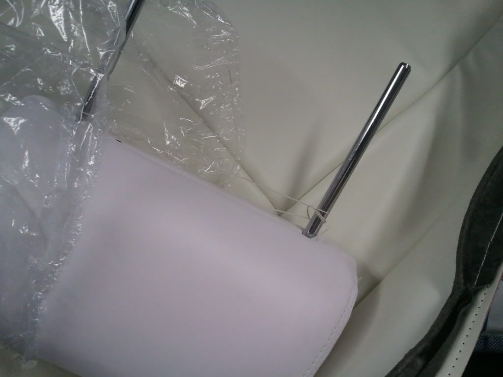

Dan, the slandering is getting ridiculous, I've never said anything on here but two years later your still out for blood,
The day you texted me and got upset it was 5am here I was asleep and did not reply, as I was asleep, your texts after that got nastier and nastier, to which I decided we should not work together and you blew up,
You know darn well we discussed the fix on the phone and I found a great match and you thanked me for that,( I also offered you to buy the vinyl from Scat and you said no) to which you said 'go for it' I said no, let's get you to look at the sample to be %100 on the same page, a week later you were upset I had not shipped anything, My supplier dropped off the vinyl you approved the day before, your dragging it out as if I purposely did you wrong. You slandered me on Facebook and on here, get over it, I'll take the compliment that you had to copycat my design to use in your car, I see your on to the next Vendor to bash.

I need to stick up for Jon on this one. The vast majority of the interior in my SS is comprised of his products, including the rear seat that I had him custom design to match my Procar Elite seats (You know, the same ones that you installed a few years later wink )
I don't know Jon personally, but as a businessman he's been nothing but great to me and other members on here that have also ordered his products.
When we were going through the process of building my rear seats, we exchanged multiple emails and fabric swatches were ordered, sent, and reviewed (And paid for on his dime, if I remember correctly) all to get a color and finish that I was happy with.
If that fell apart, I'm having a hard time believing that it was on Jon's end.
I'm getting deja vu as we had this same discussion back in '12 when you complained about not getting things your way on your schedule.

Originally Posted By: howehot
As we build our rides we learn from them and then try not to make the same mistake others have. That said, all I can do is report my findings on the products I've used during this build. I have purchased from major manufacturers all the way down to that one guy producing one piece to make my life simpler. I've learned so much and have taken this knowledge onto our next build, the El Camino. And once again have tried to use the best pieces from recommendations and needs. A few members on this forum have some of my money and have some pretty neat pieces in exchange. As the El Camino comes together I can't wait to report on said pieces and how they perform. Couple are pretty trick.
I've had 3 issues with the Monte. The interior, the EFI and the transmission. GSI interiors failed to color match to my seat and cost me time and $$$, the FAST EFI never lived up to its claims proven by 3 dynos, and the transmision, built by a very good friend, failed twice due to improper torque convertor shimming my fault, and one more time due weak links in the build. I won't ever order a product from GSI, use FAST product, or use an auto transmision on a pro touring build.
As you read this and look at your build and future upgrades, you can take my experience and use it or ignore it. I can only tell my experience and you must decide on your own.
'Failed to color match' But you approved the swatch and I paid for the material. Seabrook White ordered 6/6/12 4 yards to do a back seat and door panels.

Yup, I'm a liar and have a lot to gain from bashing you. I needed a release and you are it. I approve a swath I never received or offered until after the fact but I approved the color. My fault. Sorry to slander you I apologize.
All that need interior pieces contact GSI Interiors. They do tremendous work.
