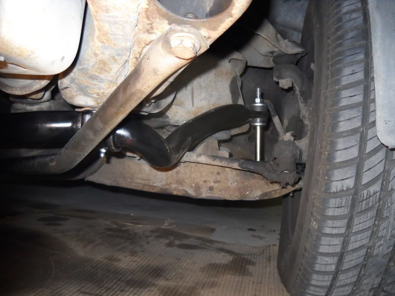

Top Down Solutions really is the Solution. They are what I used last year to install the WS6 hollow bar. Don't mess around and just get them.....your headache will go away. Here is what the brackets look like modified with zerk.
Here is what they look like in the Stock Bracket from the side. The TDS item is on the left.....the Firebird bushing is on the right...and it won't fit...lol
And this is what they look like installed.
And don't forget new end links and bushings. Install them so the ends of the bar are parallel to the road when tightened down.
