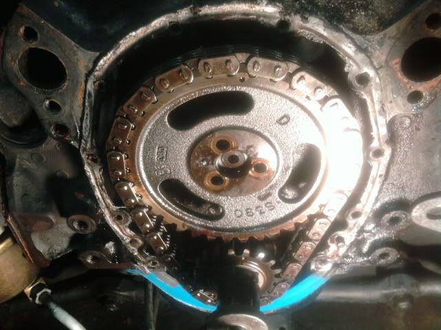

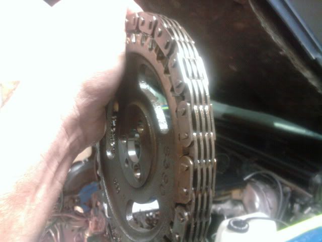

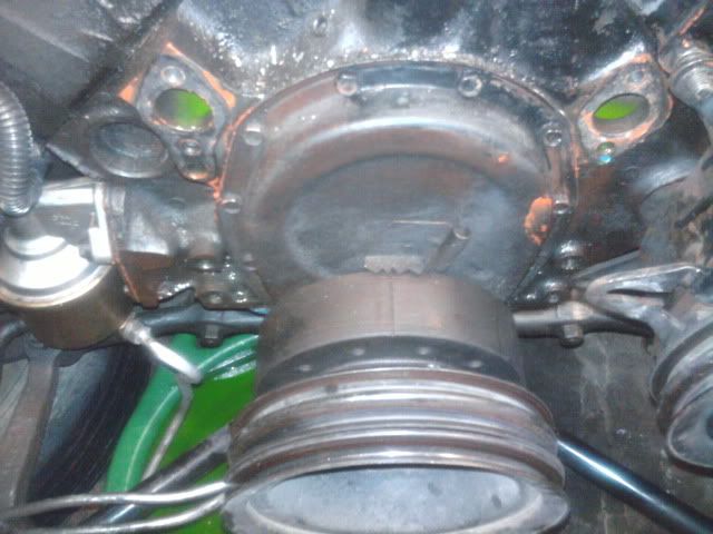

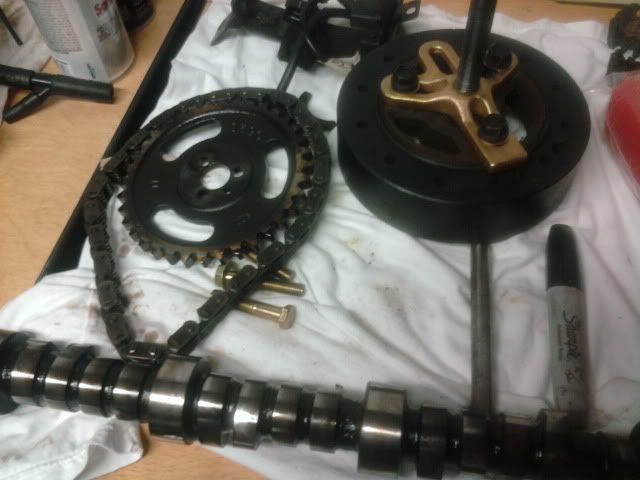

Got a little work in this afternoon.. Finally broke the crankshaft pulley bolts free and got the timing cover, chain and cam out. Dummy alert - - - I broke two socket extensions off before I had the sense to use a deep socket instead. I used a large pipe over the ratchet as a breaker bar.
Is this the original timing chain? I was expecting a single chain. It and the cam look like new. Is there a way to tell if it's actually the L69 cam?
Should the chain have this much play? (click for video)

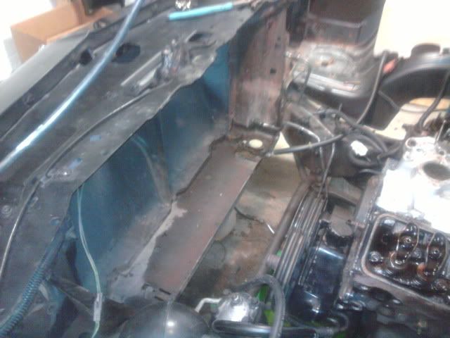

It's going to be 68 tomorrow. Not ideal painting conditions but for Nov 21st, I'll call it good. Gonna degrease the block and the firewall and freshen it up. Black it is.
If I have time, I may try to sand and paint the brackets and pulleys. How does the steering pump pulley come apart?

That much play in the timing chain is very common in high mileage motors. You have to have a puller made for pulling power steering pump pulleys to get it off. The same tool will also work as an installer. Autozone sells them for around $28 to $30.

I just put a brand new timing chain set in my 350 vortec engine and there is the same amount of play.

Thanks everyone for the inpout! I'm going to pull the heads this weekend, clean them up a bit and install the stem seals.

Well, the Mrs. gave me my Xmas present early (air compressor) so I borrowed an impact wrench and started removing the bolts from the heads.
I'm running into a couple of places where I can't get the wrench in there very well... the last bolt towards the firewall on the drivers side, and the last few on the passenger side. I guess I could just remove the heater box and master cylinder, but I'd rather leave them on. I only have a 3" extension bar. Would a universal joint give me enough off-center room to get them out? Anyone done this with the engine in the car?

Do you have a 1/2" breaker bar? Gotta believe the bolts can be removed that way without an impact.
