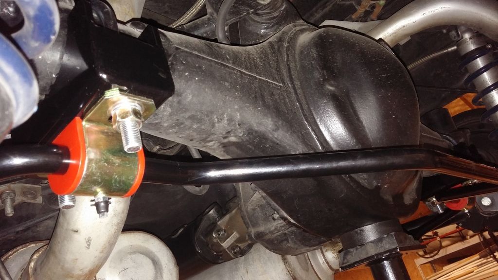

Last night I installed a third chassis mounted Pro-Touring style rear sway bar on my car. The first one I never even finished with the install because it would not clear the lower control arms I had on the car at the time (the company graciously accepted the return). The second one required me to heavily modify the axle mounts to get it to clear my 9Ē housing and also took quite a bit of reconfiguring to get the end links to clear my tail pipes and lower control arms. I took it back off right away after testing showed it to be much too stiff for my application.
For over a year now I have been asking Ramey at UMI Performance to build a chassis mounted rear sway bar of the right size to work for how I use my car. They did just that and I finally ordered one of their ĺĒ solid rear sway bar kits for a G-Body and installed it last night. Iím not kidding when I say it took me less than hour start to finish for the install. The hardware UMI provided with the kit is top notch and everything fit just perfect on the first attempt. For example, the brackets used to attach the end links to the chassis, the other 2 bars used a single bolt to hold the brackets to the frameÖ the UMI kit uses not only 2 bolts but also a reinforcement plate behind the chassis to secure the bracket to the frame.
And the end links are short enough to allow the bar to sit at a decent angle even with the lowered stance my car sits at.
The bar clears the axle housing with zero issues and sits just about as perfect as it can.
Overall, Iím impressed with the build quality and more importantly the design that went into this product. I canít wait to see how it performs on the street and on the track. My first autocross test n tune is April 9th. Iíll have my new UMI G-Body front chassis brace installed by then as well.

That looks pretty good.
The only downfall is the center section of the rear won't allow you to move the axle mounting points inward. That would be a big benefit if the bars rate is a bit too much in it's outboard mounting position. If you had any other rear that option would be there for optimization. You would be surprised how much difference just moving the axle mounts in or out changes the bars torsional rates. Good thing there is the extra hole on the spherical rod end of the bar that will help ya a bit too.
Is there a reason you don't have the axle mounting positions equally centered on the housing?

The sway bar mounts are actually both 4.5" in from the lower control arm mounts, so they are equally centered. The pumpkin on the 9" is offset on the axle a bit.
Also there are 3 holes on the bar itself for adjusting it's rate. I have it in the center hole for now.

In the picture it don't look on center at the axle mounting points. Not going by the center section but the sway bar itself. But that could be the photo angle I guess??
The holes at the spherical rod end I seen, those are good. But having the side to side movement at the axle would be nice too. Softening it up more if you needed too.

Make sure you check the clearance between the housing and bar at full compression. The bar will rotate closer to the housing then. When you change from the softest setting to the firmest setting on bar you will increase the amount the bar will rotate, this due to the change in the bar's short arm length, the shorter the arm the more it rotates. Been there done all that on a Spohn Pro bar.
It's a good idea to keep the links close to plumb, straight up and down at ride height. Not sure if UMIs instructions say to loosen the u-bolts on the housing to get the links plumb, then tighten them in that position. You must check the bar rotation in all settings in full compression to insure it doesn't hit the housing. Hopefully all that homework is engineered into the new bar.
What I did to fix all that was make a new set of frame brackets with matching hole locations to the bar, that way all I do is change the link at the bar and bracket, the links are always plumb at ride height, don't have to touch the housing pivot point. I'll send you a pic of the brackets, they are overkill build, only had 1/4" steel laying around, but I knew at full stiff there could be flexing at the frame location without a gusset.
The Spohn bar is also 3/4" solid. I run full soft most of the time, full stiff for drag racing, ran medium at last autox, no real data from that experience, you can guess why.

I'm wondering if they have a comparable package to compete with the big guys? Shocks with that secret sauce valving(fox shock).

I haven't seen Ron's dyno charts for the secret sauce. We do have our own higher rebound valve codes in the green machine right now and will be evaluating starting at Atlanta Super Summit auto-X in two weeks. Last season we ran Viking Crusaders with high rebound with good success.
The picture I posted doesn't show it well but the bar is miles away from the pumpkin housing. That picture is taken pretty close to ride height and my fist will still fit between the bar and my 9" housing.
I put my axle brackets on the tubes level front to back (at ride height) so the sway bar is directly below the axle tube and the middle hole on the end of bar for the end links is directly below the chassis bracket. The end link will swing forward just a touch to go in the forward hole, and back just a touch to go in the back hole. No need to plumb bob anything with this bar, it just fits perfectly.
It's like Ramey read every complaint about how the other bars on the market fit and corrected everything at once with this design.
I also like how the UMI axle brackets have teeth on them to dig into the axle tube, the Hellwig brackets were smooth and that bar twisted on the housing while testing a couple of times. It needed to be at least spot welded to hold its place. I'll put witness marks on this to watch it but I don't think it will go anywhere.

Is there already holes up there in the frame cross member or did you have to drill?

Just did my initial test drive on the street with the rear bar installed and I like how it feels so far. There was too much traffic to get too sporty but I was able to throw the car around a bit and it feels good.
I'll have my Hotchkiss 1" solid LCA mounted bar for sale soon. It was the only one I found that actually went around the drain plug on the 9". Of course I'd suggest this new bar from UMI but if it's not in the budget, maybe that one will work for you.

You have to drill holes to mount the end link bracket too. It's not a big deal though, they are on the flat reinforcement part, real easy to get to both top and bottom of it.
