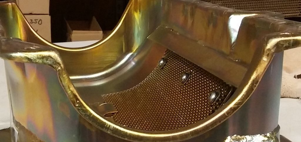

Barney is back home safe and sound, tucked away in the house garage and ready to be driven...

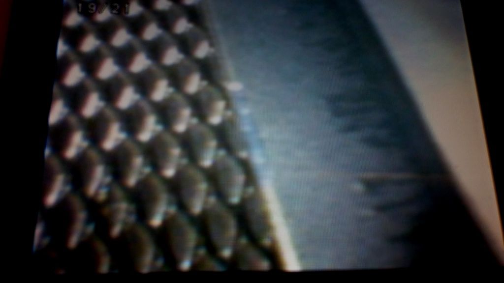

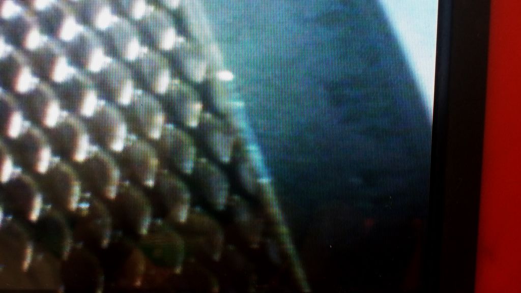

The shop raised the engine a bit and dropped down the pan. They snapped these two pictures with their Snap On scope Camera (I took pictures of their screen, sorry for the quality).
What you see there is a piece of metal that holds the scraper. On that metal you can see where a rod nut was just touching it enough to knock the plating off in one spot.
Here is a picture that shows the scraper better
They then pushed down on the metal just a bit there where it was hitting and reinstalled the pan being sure to push it as far to the passenger side as possible before cinching it down.
The rods cleared when turning the engine by hand so they buttoned it up, put new oil and filter on it and test drove it to put some heat in it and it stayed quiet. I'm calling it fixed.
I didn't like any part of this, but they assured me that it is not all that uncommon and not that big of a deal, but also realized the noise was unsettling. I'm just glad it's fixed so I can go on with the rest of my off season projects... I sure appreciate Yancy taking care of this for me, this was much easier than pulling the engine again to pull the pan which would have been my remedy.
