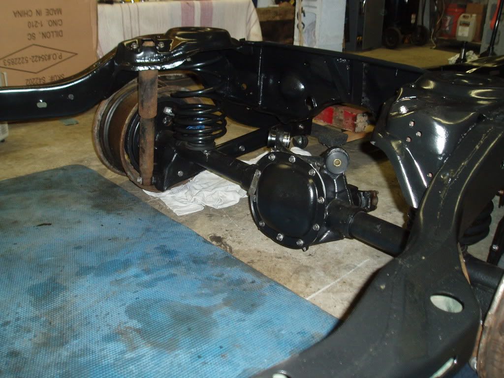

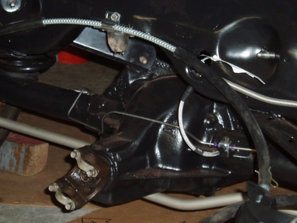

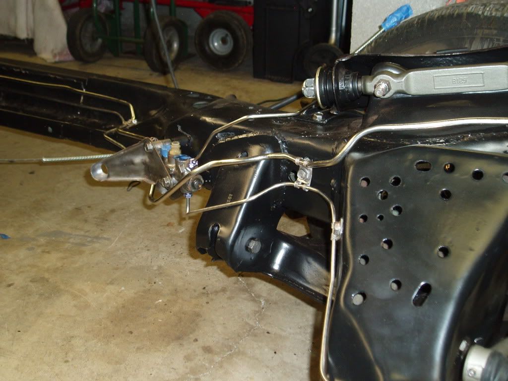

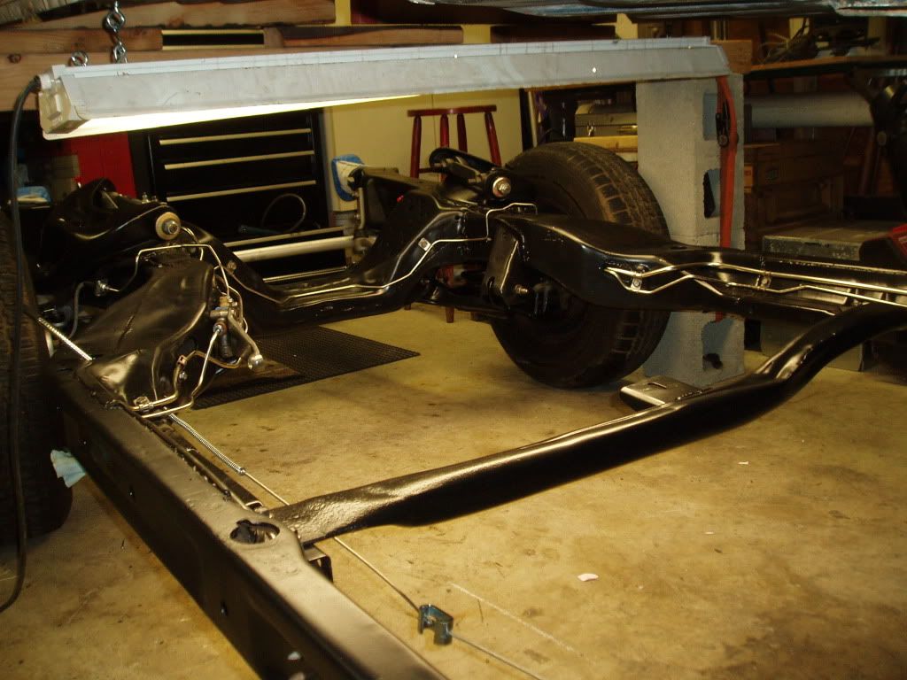

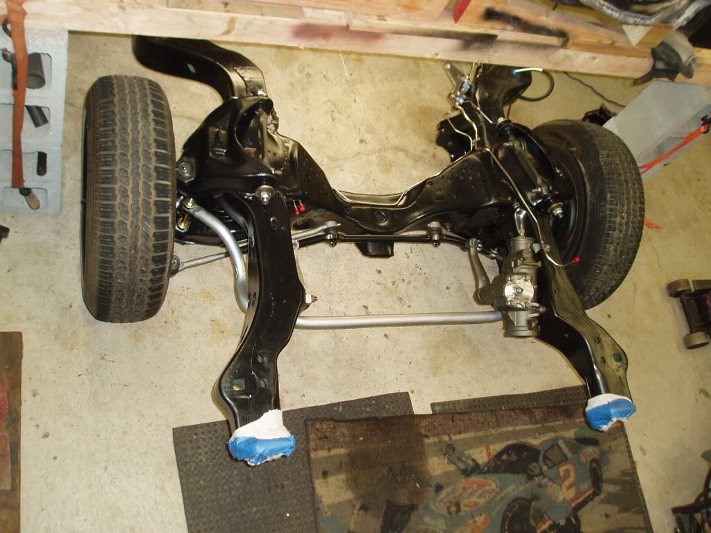

picture of frame newly painted new s/s brake anf fuel lines e-brake cables went for braided s/s flex lines for front and rear
rear with new lines
newbrake lines and proportioning valve
front with new hardware
rear mounted on frame

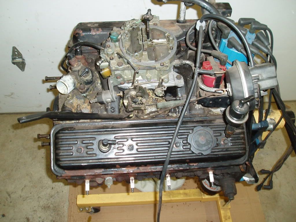

engine before tear down
all suspension was outfitted with polygraphite bushings a-arms and control arms were sandblasted and repainted for now just using the old shocks as place holders
