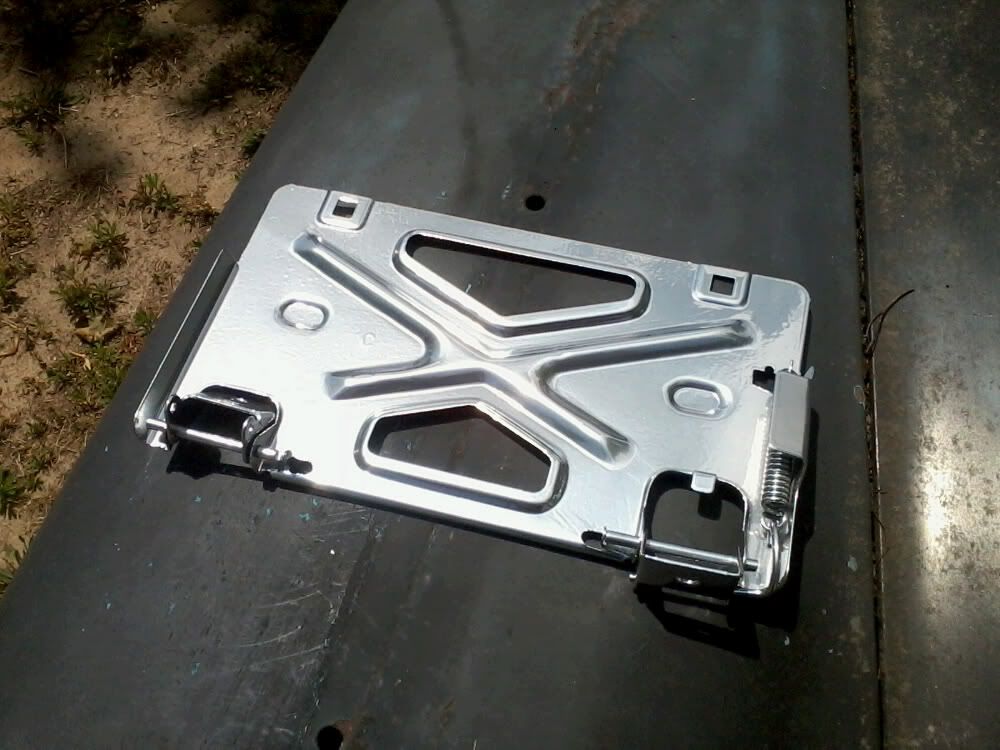

3rd generation Camaro rear plate holder that stays down when fueling unlike the factory Monte piece.Screws/plastic inserts one left off for mounting black finger hook, Round file for making holes slightly larger on plate, 10mm socket,extension,ratchet
Bare(old one in garbage can)don't over tighten screws on the black plastic housing
Lower longer screws used, leave loose for alignment once plate is installed
One white plastic insert left out of the square cut hole with black finger hook between plate and mount, fold up and align visually, fold back down when aligned and snug tighten lower screws.
Besides gas prices and fuel consumption you should enjoy fueling up again, set gas cap on plate holder when down, no more spring loaded plate holder.
