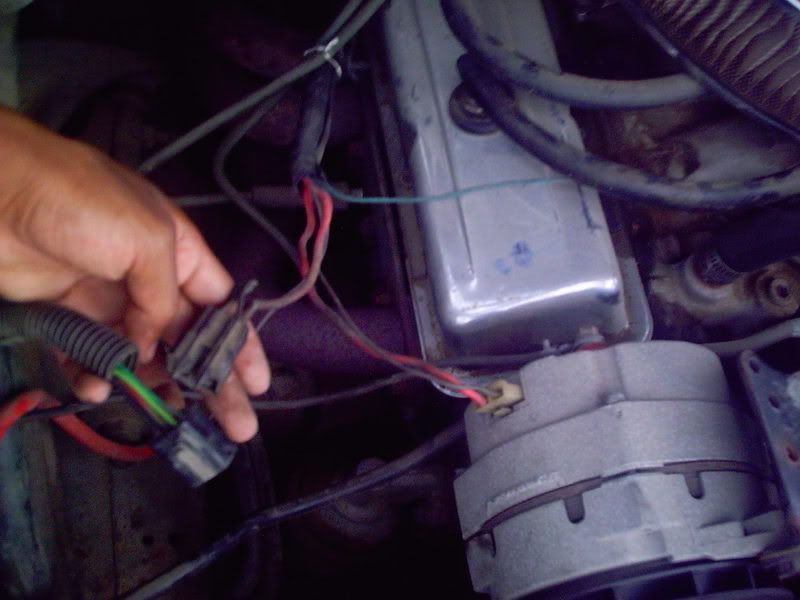

another electrical question! on my alternator, i have a black plug that consists of a green wire and a black wire. connecting these wires at the plug is a resistor, is this normal? also, the green wire is getting power, but what is the black wire for? thanks again everybody
i dont know what u mean, but here is a pic so someone else can chime in
the lights not working properly could be a simple fix. if u have a green arrow on ur dash when u turn ur lights on then it means that one of the light bulbs is burnt (depending on the side of the arrow) say u have the right arrow lit then the problem is on ur right side.... hope it makes sense i know mine wouldn't turn on, the problem is not the bulb itself (u can put the bulb either way) the problem is in the socket itself, mine still had the original GM bulb grease (which looked like lube grease IMO ) anyhoo, remove the old grease and take a look at the connectors inside the socket. the connectors loosen with time, all u need to do is crimp them closer together and they should work. to test ur sockets for a loose connection, put ur flashers on and sort of pull/push the bulb while holding the socket. i know i had to crimp all of the bulb sockets on mine to get them working
good luck

i don't have the stock harness like that anymore. the previous owner chopped it up when he took out the computer. i have a small block 350 in now, the alternator doesn't have a red and a black wire, it has a green and black. i'm just wondering what the wires go to. i'm assuming that the green wire is getting the juice, does the black wire go to the electrical gauge? thanks
