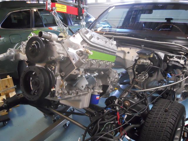

I removed the front clip when I did the LS swap. I did mine piece by piece, bolt by bolt to avoid damage. But you can do it as a unit. It will be heavy and you might tweak something if you remove it whole. This is also a good time to rebuild your door hinges.
Second foto shows the nose removal. Red arrows point to "protrusions" on the ends of the aluminum bumper that can cut into the sides of the soft SS nose. I ground them down about a 1/4" on each side. The eggcrate is important for maintaining the shape of the nose.
No clip makes it very easy for an engine and trans install. I would not do it any other way.

It's ok to let the front clip sit on the ground as a whole structure. Scratches, nicks, dings and perhaps stressing brackets are likely to occur since it is a bulky, heavy object.
The door hinges are almost always worn which causes the doors to sag. Unless you recently installed new door hinge bushings, the time to work on them is when the front clip is off. You can see how easy it is to get to them in one of my photos.
Remove one hinge at a time to prevent the door adjustment from shifting.
