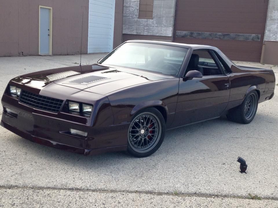

I did a conversion with an Honest Charley piece on our El Camino. Fit was great but it took a lot of block sanding to get it straight. It was fiberglass. My worry with it is there is zero bend to it. Any curb or tap is not going to be forgiving.

I personally don't think the fiberglass would break under hard corner with a stock chassis. Pretty thick and reinforced with multipal attaching points. Ours has seen very hard cornering, the Monte pulled .98g on a skid pad for Super Chevy, but the Schwartz Performance chassis stiffens the the chassis by 200% so flex is pretty much nonexistent. We also added a 2" lower valance to it and filled the body line. The extensions are fiberglass but the overall fit was great. Biggest problem was the grill. Way to small for the opening so I epoxied abs plastic to it and shaped it to fit.
