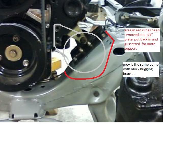

Seems i had the same problem. i drilled a small hole at the front of the crack welded it up and added some gussets. never broke another one. talked to moroso about it at one time... the are stamped and bent into position cold.

#1033323 - 12/20/15 10:34 PM Re: Look what I found............ [Re: The PC Surgeon]
Posts: 1,170
pazzo1969 Online thinking
pazzo1969  Online Thinking
Posts: 1,170
Mableton, GA
That was with the turbo six banger. i was setting the front frame with a small notch for the dry sump pump, i noticed it then. motor was at 750 with 650ish lb.ft. not sure when it broke. may have been when i blew the rearend apart a few weeks prior...pics are not in my photo bucket for some reason. have run solid mounts many times with no cracks or failures. frame was still mostly stock at that point, may have been to much flex. not sure
only pic when i was working on the frame at the time. can't see the brake
President Wicked Rides/Wicked Montes Georgia chapter
