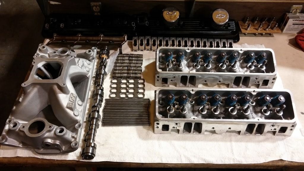

Oh yeah, here's what Santa brought me today...since I know you all like pics...
