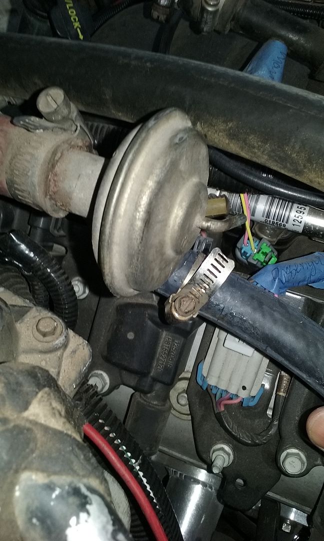

As I was plumbing in the heater hoses on my LS2 swap, I noticed the heater control valve was a bit crusty and rusty and wanted to change it. I haven't tried applying vacuum to see if it'll hold or even if the valve will move. Now for the problems:
This is the heater valve I have on the Monte
I'm not sure if its the original one but I've had the car 11 years and have not replaced it. So I went online to look for a replacement but they pretty much all look like this...
http://www.oreillyauto.com/site/c/search...;make=Chevrolet
I then started thinking I might not have the right part on the car but I've looked at some low mileage Montes like this one, where it clearly show the same valve as on my car.
I imagine I could get that plastic looking valve and call it a day but I'd rather have OEM replacement. I've tried looking but haven't come up with what I want.
Are they available??
Also, after having looked at the picture of the low mile monte and others, my heater valve is on the wrong line!! Does having it switched affect performance? I'm switching it back but was curious.
Thanks for the help, fellas.

I tried going through Mike but he didn't have any OEM. So I took the Dremel and an 80 grit flap wheel and just cleaned it up.
It only took about 10 inches of vacuum to get it to fully open and held at 19 inches, so I decided to not replace it.

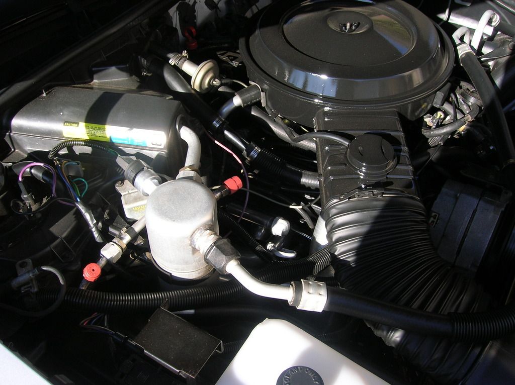

Hate to hijack this thread, Not to sure about the Control Valve, as mine is rusty and dirty looking as well. Not sure how if its on the in or out host to the heater core.
But i figured instead of making a new thread, Maybe someone would have a more clear opinion on this subject, In the OP picture, I have circled where the lines go to the heater core, in orange'ish red color, and also where i forget the name the air conditioning metal cyclinder tube goes as well. Anyways, I changed my heater core about 3 or 4 months ago, after getting it all back together. In those 2 redish orange circled area's, there was just a weird dirty old sponge type material. Now after getting it all back together, whenever i am running my heater... I can feel Air blowing out in the direction indicated by the yellow arrow's... and i never noticed that before.
Now i notice in the OP's picture.. where the A/C lines run in, its all literally sealed right up tight with what looks like some black globby type of glass butyl sealant material.
I am just curious should i feel air blowing out of these 2 area's? or should i really seal them up air tight, would this cause me to be loosing heat/blowing pressure for my heater in the car? Or is this a normal breathing type of operation for the heater housing unit, or maybe i just screwed up when i put it all back together. Anyways sorry to hijack this thread, just figured it was some what related.
I also notice in the OP's picture he has just a huge opening gap for the in and out lines to the heater core, no sealant or spongy type material at all? So now im just confused, if that was taken out for some reason? lol

the air is blowing out because you left out that piece of sponge, it acted as an insulator and keeps heated/cooled air in the car and hot/cold atmospheric air out of the car/hvac system.
