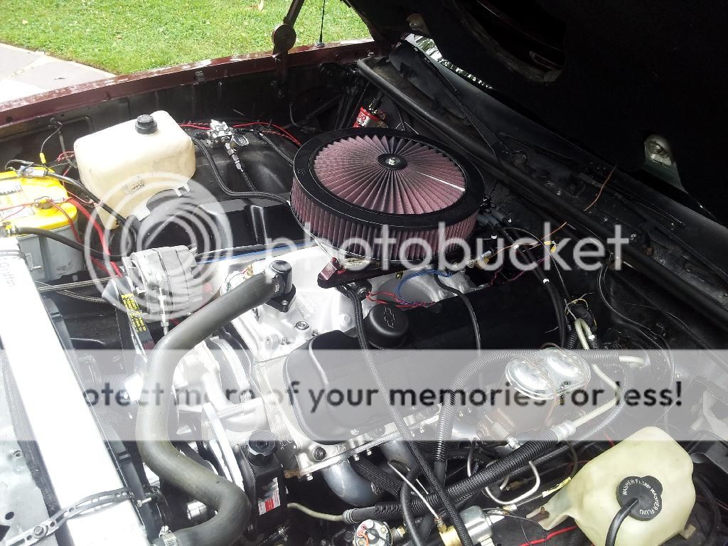

I finally got started on my hydroboost install yesterday.I got the booster unbolted from the underdash bracket and the master cylinder unbolted from the booster.Next,I need to remove the booster pushrod from the brake pedal.Getting at the brake pedal and bracket is a PITA !!! Small hands would be nice for doing this part LOL.Hope to make more progress today.Forgot my camera yesterday,but I'll take it today.
#1003443 - 05/29/14 10:27 AM Re: Just ordered a new hydro boost... [Re: GuysMonteSS]
Made more progress yesterday,got the new master cylinder bolted to the firewall and the high pressure pump mounted to the inner fender.We didnt get the brake lines hooked up yet,the rear brake line is bigger than the front,1/4 in vs. 3/16.Mark wasnt sure how we were going to proceed,so we did a google search and found adapters are available for this situation.Called NAPA and I'm going to pick one up this morning.I'm hoping we get this project finished up today.
