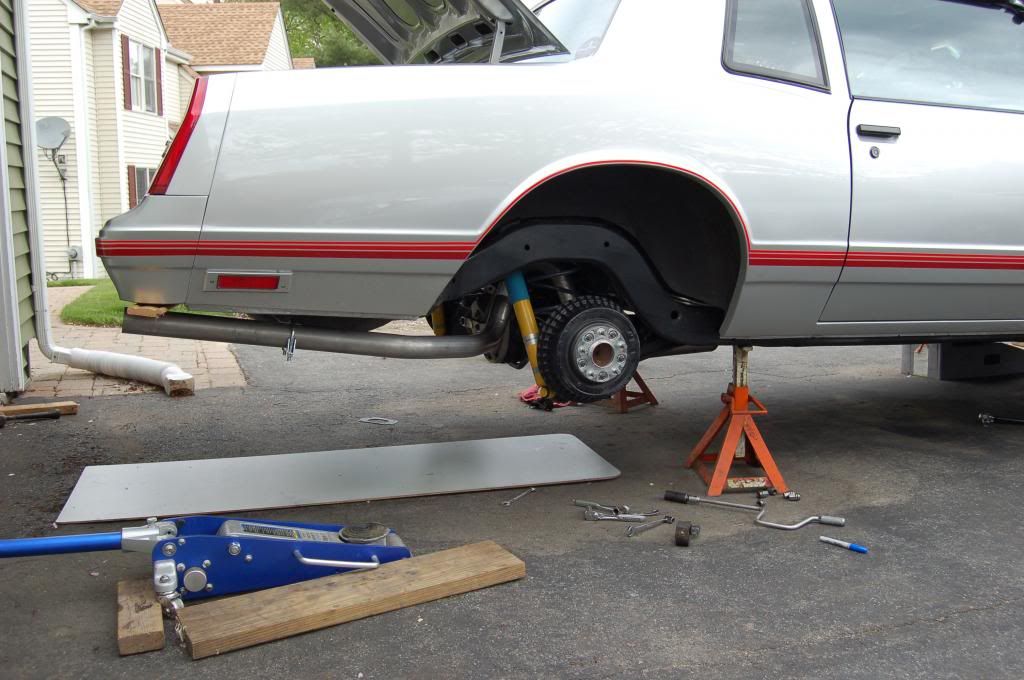

Here's the driver's side:
There's no hanger at this point but you get the picture. I can live with this.
And the passenger's side. This isn't acceptable and there has been no reply since sending these pictures to Pypes.

First off please excuse my dirty under carriage. Now on to the problem. Here you will see I am having the same exact problems as Clutch is.
The first picture shows how the system will not lay flat on the right side.
This picture shows where I believe the bending error to be in the right side tail pipe. The right side pipe (closest) should not be bent up, it should lay flat like the left side.
This is the tail pipes installed correctly and exiting properly beneath the frame rails and out from under the rear bumper.
Attempted to connect the x-pipe to the mufflers...(I knew it would not fit when it was on the ground but pypes told me that they needed pictures of it installed on the car.) When trying to actually connect the x-pipe, the "x" hit the drive shaft long before I was able to connect it to the muffler. And it looked goofy, because the x-pipe was tipped up so high on the right side in attempt to connect the muffler.
For this picture I installed the intermediate pipes into the mufflers to illustrate how far off that bending error makes when you make it to the front of the muffler. Yeah I know that's not where those intermediate pipes belong....just there to show the screwed up angles.
And just for the record, everything else fits great, the left side tail, left side muffler, and the x-pipe. Its just the right side tail that's messed up. Oh yeah, and the Jegster crossmember came out and the factory piece was modified and reinstalled. The "humps" in the Jegster are too narrow for the 355 Chevy with hooker headers.
I called pypes, they asked for pictures, I e-mailed them as requested (over a week ago), and am still awaiting their response. I am getting frustrated, and all because of one tail pipe. Hopefully they get that bend fixed and send me a new tail pipe so I can finish my installation and that so no one else ends up with this problem.
