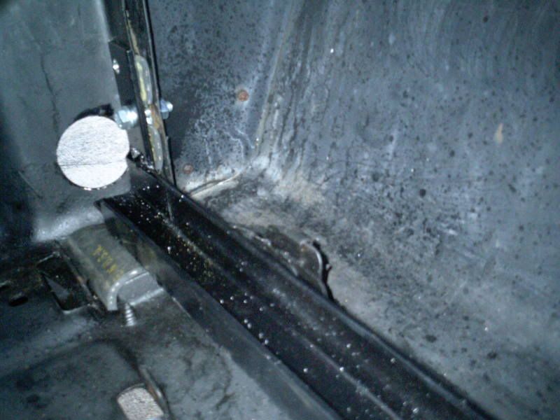

I got some pieces of wood and trial fitted them inbetween the walls of the radiator housing. Important! make sure that you will have room on the ends to get a wrench in there to tighten the push lock fittings. I messed up the top rail. I got all the way to install and had to take it out and cut it because the fitting would screw in and stop because there was material in the way (see photo with red dotted lines, I had to cut there)
back to the story. When I was happy I had my measurements. I had the C channel welded, using the corner and the 1" stock. The stock was welded to the corner with a metal nail inbetween the two (if you look real close in the photo you can see the gap it made. This gap will also act as a drain for any liquids that collect in there. nice =) when it was done I took it accross the street to the car and got inside the engine bay. I then took small pieces of 1" stock to use as the tabs to fasten this to the car. I used exsisting holes to determine where these would be placed. There are more than one to choose from. use your best judment. I went back accross the street and told him where to weld. He tack welded, went back accross the street. made adjustments and had him welded it for good. Next I took a nail and went from the back, through the exsisting holes, and made some scratches. Now I knew where to drill holes through the tabs. I also had to drill through some of the frame. youll see if you do something similar, no big deal just had to widen the hole. not too much of a PITA. Drill them out. your C channels are now made. Paint them. I used epoxy black for metal from home depot.

heres a picture of the 1" Corner beam welded to the 1" stock with small lengths of 1" wide tabs. The dotted red line is where I should have stopped originally. I had to take them off cut that end off and throw some paint on the fresh metal where I cut. PITA, my fault tho.
