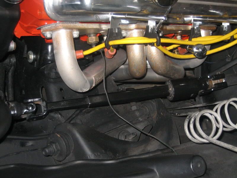

http://i17.ebayimg.com/02/i/000/d4/ed/9182_1.JPG
here it is

all right guys if you want something done do it yourself here's the answer
"A steering shaft from a 1996 era Jeep Grand Cherokee will bolt into a G-body. The Jeep shaft has u-joints in the shaft rather than rag joints, which will reduce slop."

eliminating the rag joint will probably give you all kinds of squirm in the wheel going down the road. not to mention the vibration

So anyway. The shaft is a perfect fit. My steering wheel is the straightest it's ever been, and plenty of space between the manifolds and the shaft. I breathe a sigh of relief.
So Grappler and I take it out for a test drive and beat on it pretty hard. As I said, the steering wheel is straight, responsiveness and tightness is incredible (especially w/ my ZQ8 steering box). The truck practically drives itself now! I don't have to swing the steering wheel back and fourth to keep the damn thing straight anymore! YAY! Several miles and tons of turns and curves later, I'm quite happy.
On my way home, I start thinking. GM put the rag joint in, in part for vibration dampning. Hmmm. We really didn't run it through a test for that. What can I do? Well, this being Pennsylvania, the Pothole capital of the world, and being in Pittsburgh, the cobblestone capital of the world, I figured a little more testing was in order.
First I head down some side streets where I know there are some bad potholes. Pretty good, but very hard to tell if there is any vibration when your truck is rocking back and fourth on the pothole slolam (sic?) I needed something else. I head for Squirrel Hill. (Those of you who live around here know what that area is like) I drove 2 miles worth of cobblestone streets. Not one iota of vibration through the steering column. It was a very smooth (albeit noisy) ride. I'm happy...
But wait! There's more!
I figured a speed test was in order. A lot of vibration can happen at higher speeds. Had to do it. I hit I-279. It's me, the road, the truck and a Venti coffee w/ a shot. (I picked up Starbucks). 50, 60, 80, 96 MPH.....Smooth as glass! I finish my coffee and go home.
So in conclusion, for an average $25.00 or less and 2 hours of your time, you can have this mod and eliminate that damn steering slop causing rag joint and be happy! Just please be aware, this is a PERMANANT modification. Once you cut that stem off the steering shaft you are committed. It's not a hard mod. On a 1-10 difficulty level, I would rate it a 5. If you do do it, you will love it and wonder why you didn't do it sooner. If you decide not to do it, you can remain jealous of those that have and continue to complain about your steering slop.
and this update
Update
It's now 1-1/2 years later, no issues to date with the steering or handling.

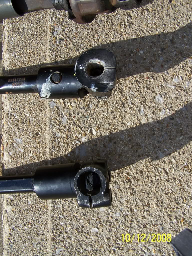

Ok guys Im going to have to put the warning stamp on this upgrade. I just got back from the yard and brought home a shaft from a 96 grand cherokee. The splines fit fine but the upper U joint does not fit. It seems too small. Also I noticed while I was at the yard that some jeeps all from 92-98 have different shafts. The one I picked up has a 7/16 bolt for the splines just like the monte has now some of the other jeeps had a 13mm bolt at both ends. The splines "looked" different I can not say for sure, but I went with what the video posted above said and went with the 7/16 bolt shaft and it does not "bolt right in" kinda pissed off I just spent 2 hours a 1/4 tank of gas $23 and I still dont have a friggin shaft!

Rob, I'm sorry you were the guinea pig. Did the shaft have 7/16 at the bottom and 9/16th or 5/8th up top also would it work up side down?? I would of beat you to this but had to play dad today instead of a mechanic (shady tree)
Posted By: robs 85ss
Re: Intermediate shaft upgrade on flea bay - 10/04/08 12:51 AM
Ok guys now that ive had some time to look at it the top U joint just might work, it is a VERY tight fit at least in my case. Tomorrow morning I will hopefully get it in. The top bolt was a 7/16ths head also. Ill take pics tomorrow and report back.
If all else fails I just might be calling up the guys at flaming river and opening up my wallet haha.

It is possible Ill let you know tomorrow. Just a fyi the new shaft does not have a bolt through the center like the original did for the top joint instead it uses a clamp similar to the one on the bottom joint.

Alright guys I have news that you will be happy to hear. I got the shaft in this morning. One thing to make the install easier, drive a flat head screwdriver into the gap of the upper U joint (where the bolt squeezes) and lube up the inside of the coupling and it will slip on much easier. Everything else is pretty much plug and play (dont forget locktite) smile The steering is VERY responsive and will take some getting used to especially if you had a really sloppy rag joint like I did. I like it a lot and would definitely recommend it. I am not sure if it would be almost overly sensitive if you were running large wheels and low profile tires, with my 15" wheels and tall sidewall tires it has just enough "play" Also one thing to mention is I swapped out my steering box for one I bought here a few years ago and apparently its a low effort box, which I really dont care for with the steering shaft upgrade. I think with the correct medium effort box (I havent looked up the part numbers yet) the car would drive great. Hope this helps! Any info on the correct box to look for would be appreciated also.
Edit: Make sure if you are getting on from a junk yard that the bottom bolt for the U joint is 7/16ths and not 13mm. I am not 100%positive but the spline looked different. I saw both shafts is 92-99 cherokees and grand cherokees so just be on the lookout.

Haha sweet!!! So just a recap because I saw way too many years.
What year Cherokees and Grands do you need to look through.
And it's a 7/16" bolt NOT the 13mm bolt.

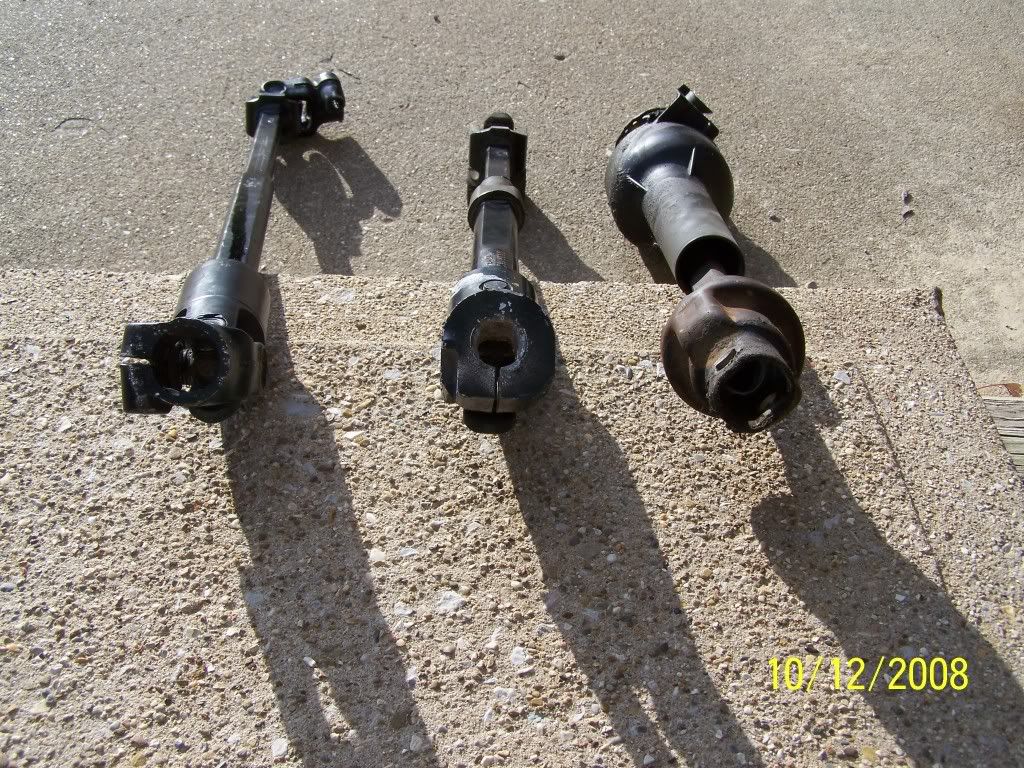

I went to the junk yard today and looked through about 30 Grand Cherokee's and regular Cherokee's. They all had the 13mm bolt at the bottom joint except for one of them which was a 89.
The 89 had the 7/16 bolt and looked the same as the one in the video so I thought I would grab it. Got the bolts out of the top and bottom but could not get the shaft out, it wouldn't collaps like it was supposed to. I pried on it, hit it with a bfh and it wouldn't come off. So does anyone know if the ones with the 13mm bolt will work or not?

ScrOOge the one I found was the same way I just unbolted the steering box (3 5/8th bolts on the frame) and was able to slide the steering box down enough to get the shaft out, then at home you just have to unstick the shaft. (clamp, hammer, wd40 ect)

I went back and disconnected the steering box and got the shaft. Now another problem. They moved the Cherokee from where it was yesterday and when I took the 7/16" bolts out I set them on top of the grill and left them there. I could only find one of them after they moved it. My local NAPA doesn't have one and neither does Ace Hardware. Called the dealership and they said they can't get it either. Does anyone have any ideas on where to get one or have one that can be sent to me? Out of all the Cherokee's I looked at in 2 different junk yards that 89 was the only one that had the 7/16" bolt.
Ron

No the the collar is threaded for a 7/16th headed bolt not for the 13mm headed bolt

Pics of the bolt I found laying on the ground where the Cherokee was sitting the day before they moved it, couldn't find the other one. It has a 10.9 on the head which I thought means it is metric but takes a 7/16" socket. Couldn't find one the same length at Ace. I don't know if it matters if the whole bolt is threaded or not. If not I could probally find one at Home Depot.

should not matter if the whole length is threaded or not... most longer bolts are not as to reduce machining costs

I dont think you are going to find that exact bolt anywhere... I just checked it out and it does have a 7/16 head on it ,but the threads are metric.... Best bet would be to go back to the junk yard and get one from an 80s gm car/s10. Also I saved one of the 13mm bolts from the other jeep steering shaft and it has smaller threads than the 7/16 headed bolt.

Posted By: Scr00ge
Re: Intermediate shaft upgrade on flea bay - 10/12/08 10:00 PM
So I went back to the yard today for the 3rd time and I still don't have one that will work. Today I got two with the 13mm bolts, one for me and one for a friend. Got the old one off the Monte and compared it with the one I got from the 97 Cherokee today with the 13mm bolt. The end that goes to the steering box will work, but the end that goes to the steering wheel will not work. It is way to small.
Look at the pics.
The one on the right is out of the Monte. Look how big the opening is. The one in the middle is out of the 97 Cherokee. Look how small the opening is. The one on the left is out of a 89 Cherokee with the 7/16" bolts. The opening is the same as the Monte's but the shaft is frozen and I can't get it to collaps.
By looking at these pictures, you should know as soon as you look at them in the junk yard if it will work for your g-body or not. The one on the top WILL NOT work, the one on the bottom WILL work. The other end is the same on all of them and is not a problem.
Hope this helps anyone that is going to do this upgrade.
Ron

I dont remember the year change for the Grand Cherokee change. The earlier Grand Cherokee's have the larger uppper portion. There was an additional change with the very latest boxy cherokee as well. So for you other junkyard hunters be sure to look at the upper portion before you pull it.
Here is where scr00ge compares them:
Look at the pics.
Ron

91 Cherokee works. There is one a year or so off that will not work. Bolts are 11mm head. Same bolt as the lower one on the g-bod but different size head.
It WILL NOT COMPRESS ON THE CAR. You will have to either pull the steering column loose or remove the steering gear to get enough play to get it out. Trrying to compress it on the car will damage the rubber isolator in it.
When you get it home fold the u-joints over and place it vertically on a board on concrete. Then hold another board the same on top. Then have some one hit it with a sledge. It took half a dozen hard hits with a 3lb sledge to get mine to compress with a helper holding the shaft and board.
The ends will not easily slide on. So... Place a piece of steel in the gap and put a sarcificial bolt in the joint backwards. Tighten the bolt against the steel plate(washer) until the collar spreads open. Give it a couple good cranks on the rachet. Then remove the bolts and washers and install.
The lower end is the same as the old one. The upper is a little different. The OE shaft had a bolt going through the shaft while the new one is a pinch bolt. The shaft is ground flat on the side of the bolt but not enough to clear the bolt.
So you can either measure and grind a slight groove for the bolt to fit into or you can just force the boltt to thread into the edge of the shaft then it'll go the rest of the way and be very tight.
Do not force the upper part of the shaft on by heavy hammering as that can damage the steering column bearings which are very fragile. Make sure the collar is spread enough to slide it most of the way. A few light taps are OK but don't try installing the shaft without spreading it first.

Has anyone installed one with Hooker 2050 headers? I just put the one in my LS Sunday, it fits fine but is very close to the #5 primary tube on the headers. Not sure with engine movement if it will hit or cause any problems. I don't think so but don't remember any being so close to the tubes that I've seen pictured.

Were you able to use the top bolt to tighten the top of the steering shaft? With the bolt loosely threaded, I wasn't able to get it on the bottom tip of the steering column (Or whatever it's really called), and I was only able to get it on there with the bolt off and some persuasion from some love-taps with a hammer. It's on there very snug right now, but I wasn't sure if this was normal.
Also, I had to turn my steering wheel a little less than 45 degrees to the right to get it to line up with the shaft. My tires are straight right now, but the steering wheel is off. An alignment could fix this, right? It'd really bug me to be driving straight with my wheel crooked off to the right.
Posted By: Monte_ExpreSS
Re: Intermediate shaft upgrade on flea bay - 03/30/09 03:42 AM
Yes, they fit tight on the upper part of the column, & you have to catch the bolt after you get it on. Also, the threads of the upper bolt will just catch on the column part, but that should help it stay tight. Remember to use some loctite too
Not sure why you had the issue with the steering wheel being off? If you started with the steering wheel & wheels straight, you shouldn't have a issue.
Posted By: SS Ninja
Re: Intermediate shaft upgrade on flea bay - 03/30/09 03:50 AM
Yeah, that was a little bizarre to me. The best I can explain it is that on the steering box there's a flat spot, which is how you align the bottom part of the shaft, as the rest is all splined.
Once that's on, the top part of the shaft will only fit the steering column if I move the wheel, as the steering shaft can't rotate seeing as it's now attached to the steering box.
Both the wheels and the steering wheel were straight when I pulled the Monte shaft off.

Just installed my shaft today. Pulled it from a 94 Grand Cherokee. This particular shaft required zero modifications, a true bolt on. I run Hooker 2150s and have about 1/4" clearance between the #5 primary and the shaft. Not a bad mod for $15.

My Ebay "93-98 Grand Cherokee Steering Shaft" came in this week. I used a die grinder to open it up at the firewall end, made a notch in the in the steering column shaft with the Dremel, and she bolted up like a charm. Total install, including fab, was probably two hours. The bolt threads in both ends of this particular shaft were 3/8-16 (I thought for sure they would be metric).
Comparing the Jeep shaft to the stock Monte shaft.
Modified and being installed. That's Anti-Seize in the opening; used it for lube as it was in arms reach.
Ready for the first test drive.

Re: Intermediate shaft upgrade on flea bay - 10/31/09 06:40 PM
Paul, an honest man like you, I'm sure next time you make sure they look it up correctly. poke
LSJM1, there is quite a bit of difference in the size of the openings; had to remove about 1/2" total from side-side and top-bottom. If you have a vice, grinder/drill, and bits it's no big deal at all. I would have gotten the correct shaft to begin with, but didn't do enough research before I placed my bid on Ebay (advertised as 93-98 Grand Cherokee shaft). I paid ~$30 TTD, and now believe it was completely worth it.
The shaft fits nice and snug now, and it's amazing how much different the car is to drive with it.

I wanted to put my input in after the install of one of those Jeep steering shafts and driving with one for a while.
I put one in my 82 Buick Regal, on my YA GN steering box, I also have headers on my Buick 455 thats under the hood.
Awesome, lots of clearance!
Driving? well let me say I took my Regal down to TN back in Sept, to hang with the Guys from PRO-TOURING.COM and their anual "RUN THRU the HILLS" event.
Didn't do in any auto-crossing in it, but did do the TAIL of the Dragon, a 11 mile road with 318 turns, It performed flawlessly, nice n tight , no slop, and more road feel.
I really enjoyed actually driving my car for the first time, down and back, 6 hrs each way, and during the event.
Now I will point out I had to change steering boxes, before the event, my orginal GN box had a dead spot at center that I couldn't adjust out, so a low milage used one went in, thanks to the host of the event, BILL HOWELL from MUSCLERIDES.COM and the use of his awesome garage called the "TOY BOX".
So for those of you still sitting on the fence about it, go ahead and do it.
