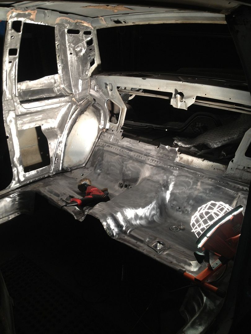

Little update almost have inside stripped so i can weld in the floor . Hoping to be welding the floor in on the weekend . Dash is out and all wiring and stripped of paint

Making good progress . Floor is almost pre drilled to 5/16 for plug welds . Have to still drill the brace and seat mounts.

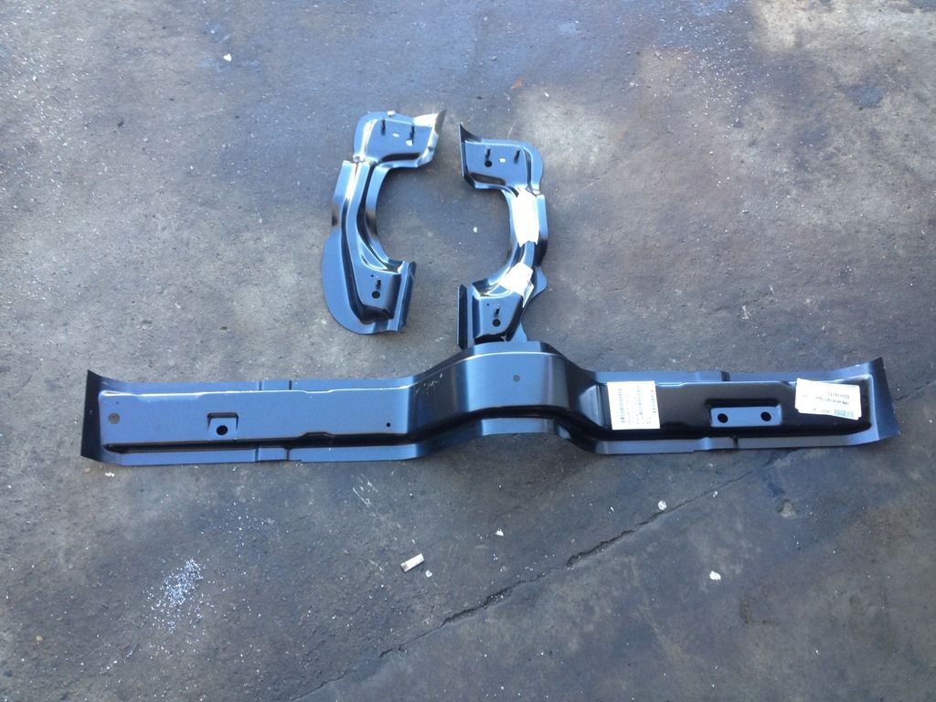

Started fitting the seat crossmember in place . Have it clamped and marking spot weld locations. So far it fits like a glove just literally popped in place when clamped

It's nice to know all that metal is protected by the e coat.

What did you use to clean the interior of your car?
Posted By: 84ss355*4spd
Re: My 84 monte ss resto , floor pan and more - 06/04/18 01:04 PM
Stripping the paint inside you mean ? I used grinder with wire wheels, drill with various sizes of wire wheels ..the i sprayed it down to protect the bare metal with the por 15 rust preventor/remover .

Here is a shot of the driver door open .heres a tip if u get wheel houses get the complete assemblies.they fit to the rocker properly .passenger side i got seperate pieces and the arent even close at the bottom front where it meets rocker flange.there is a little extensi9n off the outter rocker that is a welded spot when together and they dont even come close to meeting up amd the shape is way off .the complete one on driver side fit like a glove once positi9ned and looks like factory in the wheel area
https://ibb.co/Jk7nx84
Below is the pic of the 2 pc wheelhouse installed the ends are not even close to what they should be and u can see the outter rocker tab!
https://ibb.co/ggF9Dzb
Re: My 84 monte ss resto , floor pan and more - 08/31/19 07:31 PM
Here is the driver side in comparison .ignore the dust lol.so sometimes aftermarket fits good and sometimes it doesmt .u have to go all in sometimes to have a good fit.i think i might ditch the passenger halve wheel houses and get a complete one . The difference is huge
https://ibb.co/7KrdB8T

https://ibb.co/FHcRcLH
Body is officially off. Now to clean up the underside where the frame was . At least I know my welds are strong
Posted By: ls1_monte
Re: My 84 monte ss resto , floor pan and more - 08/07/20 01:36 AM
Looking great, im diggin that side shot with the qtr, door, fender, an rocker all black really looks like its comin together. If theres one thing someone could say about us is we are persistent for damn sure.๐Ÿ˜†
Re: My 84 monte ss resto , floor pan and more - 11/02/20 12:02 AM
Thanks.it feels good for sure.next summer I should have it on the frame .too funny .you gotta be a little crazy to do this type of resto that we are doing .keep checking in buddy I'm always checking
